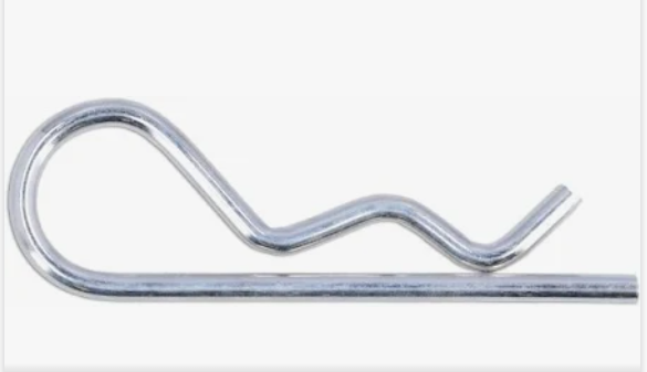

Would R clips work on a caliper?
Screenshot 2024-02-27 08.02.42
