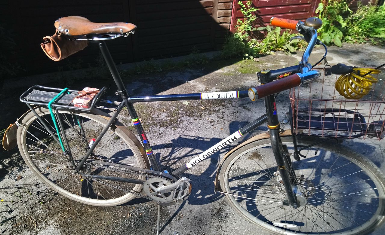

SRAM Automatix and North Road Bar? I give you my shopping/commuter bike...
Shopper/Commuter
However, I don't think that's quite what you are after, with your frame, and while avoiding drop bars, I would still go for something a little lower, ideally flat, which happens to look better, like a Nitto Dove, or Velo Orange Porteur or Milan?
