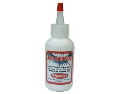

I'm converting to tubeless!
I'm using Eclipse Tubeless kit, DT 5.1 rims, Bonty XR4 tyres and Stans sealant
I've finally managed to seat the tyre onto the rim/tape using a ghetto accumulator. No way do I want to unseat it to pour the sealant in, so I've tried to get it in though the valve with the core removed. Problem I'm having is the nozzle on the bottle doesn't fit into the valve, so quite a bit of the sealant is pouring out over the wheel (onto a conventient rag Ii had the foresight to put in place).
The bottle is showing about 2floz has gone, which should be enough for the tyre. Its sealed some holes, but not all, so I'm not convinced enough sealent has gone in.
What are you techniques for getting the white stuff into the rubber? (sorry, schoolboy humour)

I use the Joe's sealant bottle - it has a narrow end on it that fits.
Maybe have a look at any old chain lube bottles you have and see if the nozzles on those woudl fit properly?
Posted : 12/06/2013 12:08 pm

What size bottle are you using? A smaller bottle with a finer nozzle?
http://www.notubes.com/2-ounce-Tire-Sealant-P154C14.aspx

Ooh, I'll be watching this. Just about to do the same, and planning on putting the sealant in through a Stans valve with core removed, using the 2oz Stans bottle...

I've got the wheel in a jig, with the valve at the bottom, trying to pour it in. Its from a 16oz bottle and with the tip of the nozzle snipped off, its too big to go in the valve.
Plastic syringes may be the way to go. I think I've got a spare one....

I use one of these little bottles. The tip fits perfectly inside the valve.

[url= http://www.tredz.co.uk/.No-Tubes-The-Injector_59550.htm ]This...[/url]

No Tubes Injector looks useful. I'll go with the cheaper generic plasitc syringe and a piece of silicon hose. I may even have a valve adaptor I can use on the end...
Is there any negative effect of having too much sealent in the tyre? other than extra weight?
