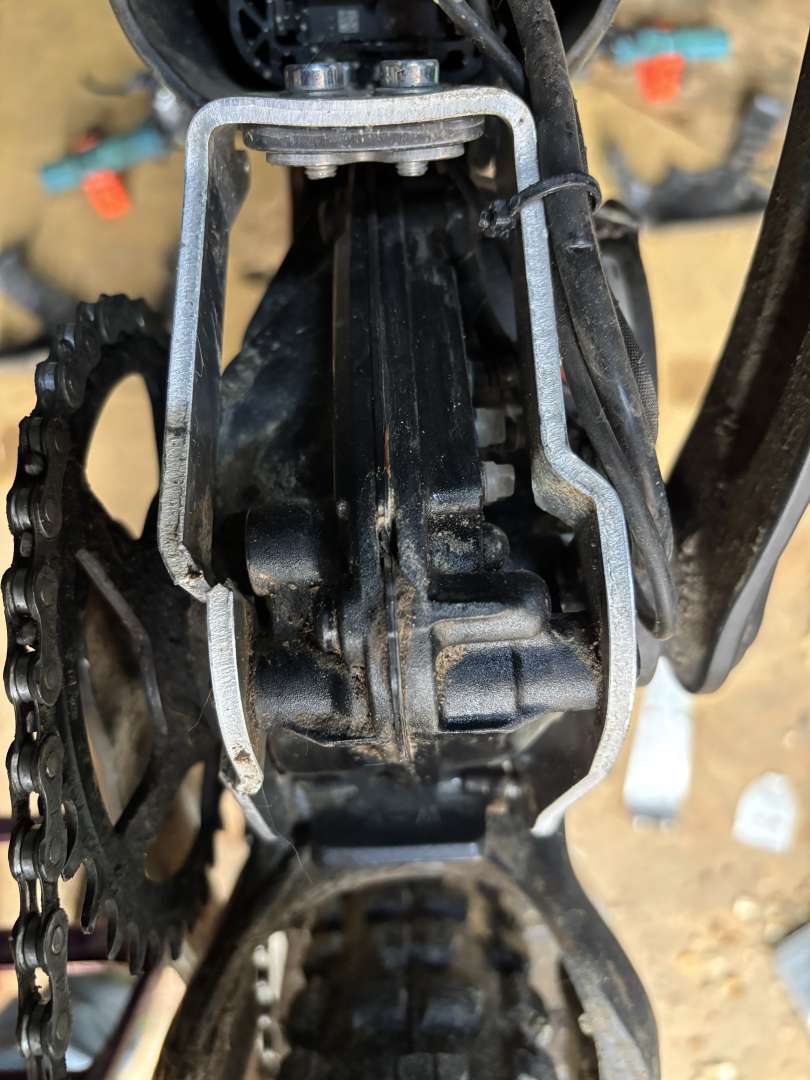

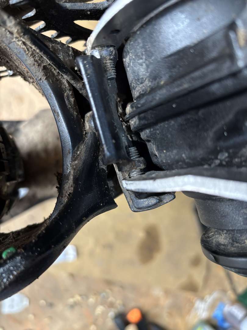

It teased me initially and made itself known by snapping my nearly new KMC ebike chain, thought it was that and repaired it, but then once fixed, the chain kept jumping off the chainring so I checked for crank / motor play and the motor (Bosch gen 4) was rotating slightly. The noise was really loud and I probably know why, the motor cage snapped in two places and took a frame bolt with it, the thread in the frame is ruined and hard to tell, but the tab could be bent too. As it’s pretty new, just waiting to hear back from Paul’s cycles re getting it sorted.
Seems an odd thing to happen?!? Although that said, the anchor points could be better! Pics attached…

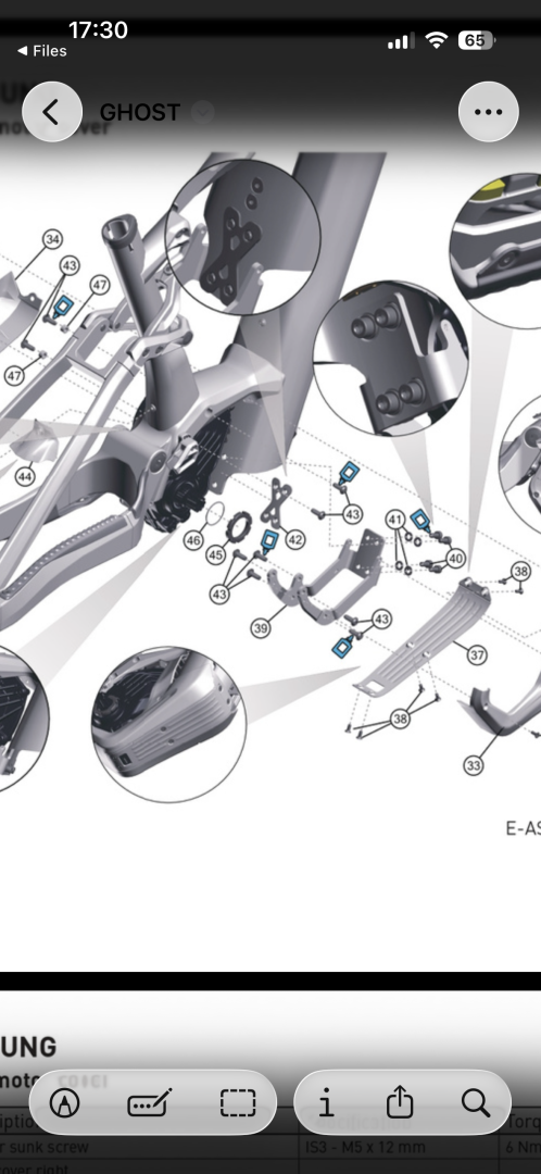

@steamtb can you post a picture from each side? I’m trying to work out the role that the chunky metal bracket plays. I.e. is it just to support the motor or or is it part of the strength of the frame?
Posted : 21/02/2026 2:44 pm
Posts: 693
Posted by: wheelsonfire1

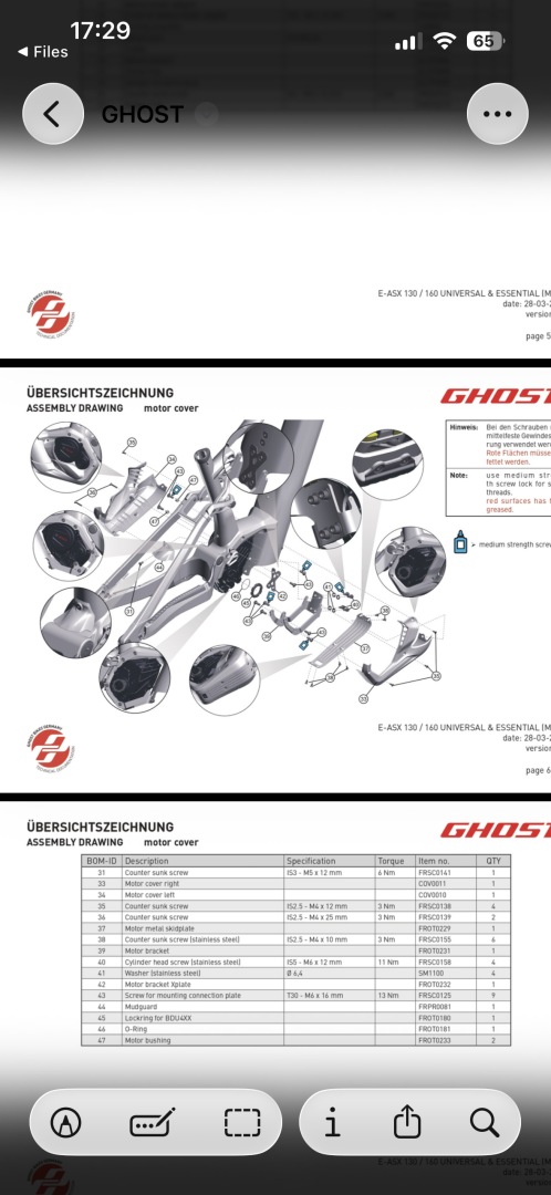

Its number 39 on here:
Posted : 21/02/2026 6:31 pm
Posts: 3027
Looking at that diagram and the damage it makes me think that the frame has bent or twisted, or both. The cradle has not coped well with the resulting  forces of being under tension? Is the cradle steel or aluminium?

I said that when I contacted them, I suspect the frame, and at least the insertion tab, may be bent but hard to tell. Aluminium I believe…

That aluminium cradle looks like it would be a very weak point. All those bends are very exposed. Unless, of course, the cradle isn't a supportive structure and is designed to protect the motor? And purposefully fail if struck?   Hard to tell from the pictures.
Posted : 22/02/2026 11:08 am
Posts: 3027
The metal, which is fairly thick has failed at the points where it’s been bent, the points where the material has already been stressed during the process. Either the grade of metal was unsuitable or the treatment process after was not correct?
The majority of the rider’s weight will be on the motor mountings (through the cranks), this weight is magnified during jumps and landings. This failed bracket appears to be part of the load bearing “structure”, I think the OP has been very lucky not to get injured!

Looking at this, and the parts diagrams online, the mount to the bike at the front (4 bolts) does look bent. The purpose of this metal frame is to adapt the Bosch motor to fit the frame. Some of the bolts labelled 43, I think the ones with threadlock, go into the motor, and are an integral part to holding the motor into the frame. My expectation would be new frame, and potentially new motor casing. Easiest to give new bike. What caused it crack like that though? The bends in the bracket are clearly the point of failure. Yikes. Good luck getting it sorted.
