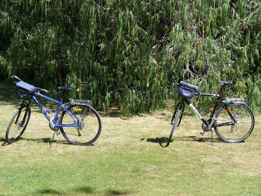

my madison stainless steel rack was good for 3 and a bit months touring mostly on road(all be it rough) but with stretches of off road round nz was fine on my girlfriends kona dew plus which had disks !
Mine(same rack) had 30kg on once i had all the water and fuel on board and Jaynes had about 20kgs in
