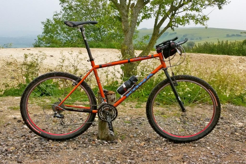

Sorry if this goes against whats printed on a website. Its hard to explain- when you jump on a bike and think 'ooo that just feels [i]right[/i]' 😀
Here it is:
I'm 6ft1.6 BTW.

Another STW- (I hope I can talk for him)- hes over 6ft and rode a 20" 456C for ages and on some descents he struggled with it. He bought an ex-demo 18" 456C and I've not ridden with him since hes had it but I've heard hes turned into a bloody DH'er on it. I think it was the confidence - it helped him that bit that he needed.

That's a nice bike hora. I approve 😀
