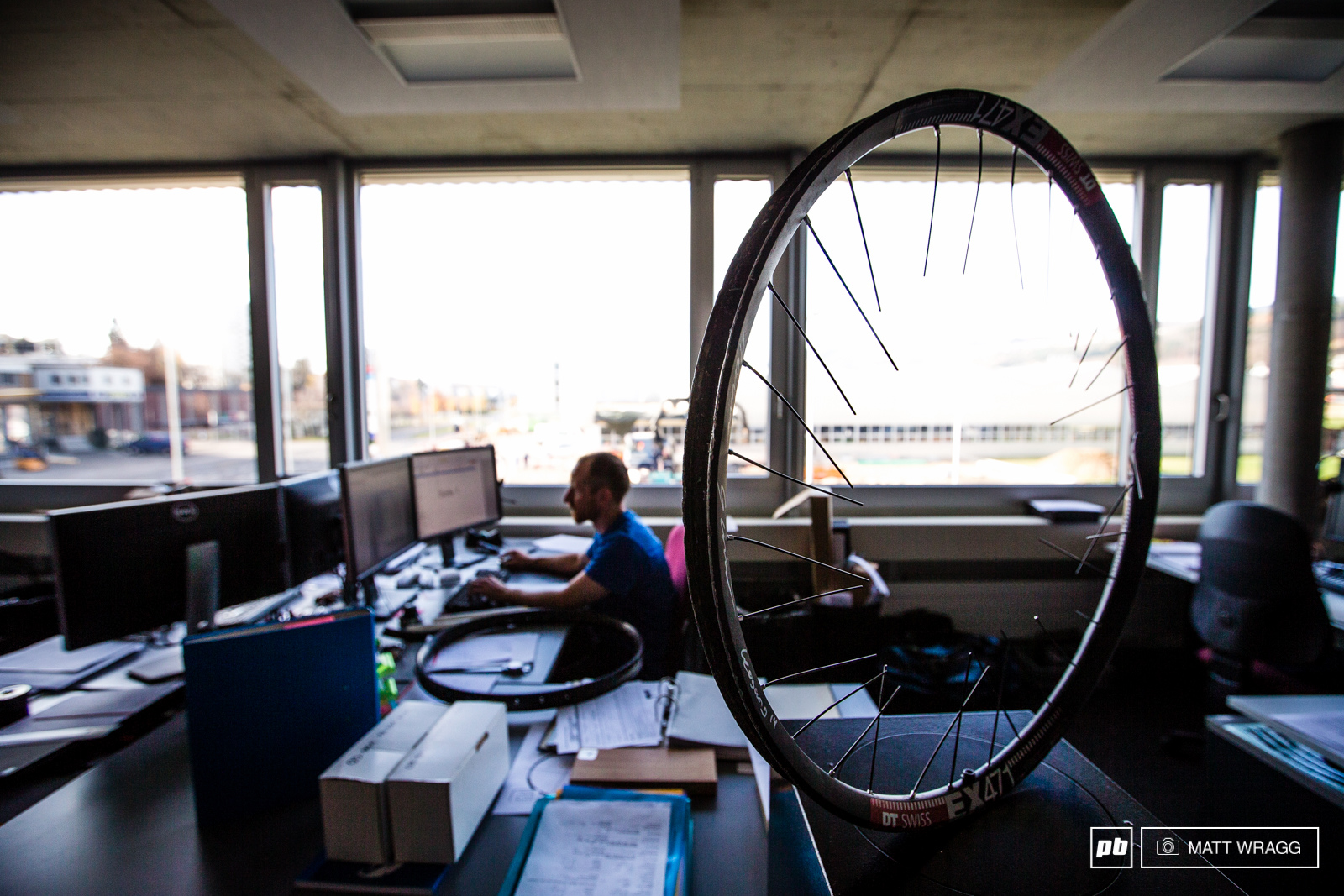

I'd lean towards the Ex471 - here it is in action
And here's the rim afterwards.

I don't think I'd go flow ex these days, not with the new stuff that's come out since- they're decent but they're not massively tough. WTB Frequency's definitely worth a look, not as light but properly tough.
(said this before but yep Aaron Gwin rode on that rim; what does that tell us civilians though? If I was going to choose a rim to use without a tyre it'd be top of the list but if I get a flat, I stop. And while it's impressive it didn't break, it was still ruined pretty much instantly.)

It tells us civilians that he chose to use an EX471 for a World Cup DH race which must be a pretty good recommendation in itself.

It's mostly a bit of fun, but it does mena Specialized DT & Dwin all trust it for World Cup DH, even though it's sold as an "Enduro" rim.
Beyond that, it's lighter than a Flow and tougher, I'd say it was definitely tougher than an Arc based on a few reports, and when I was pricing rims recently it was cheaper than either. I'd be going for it if it was me.
