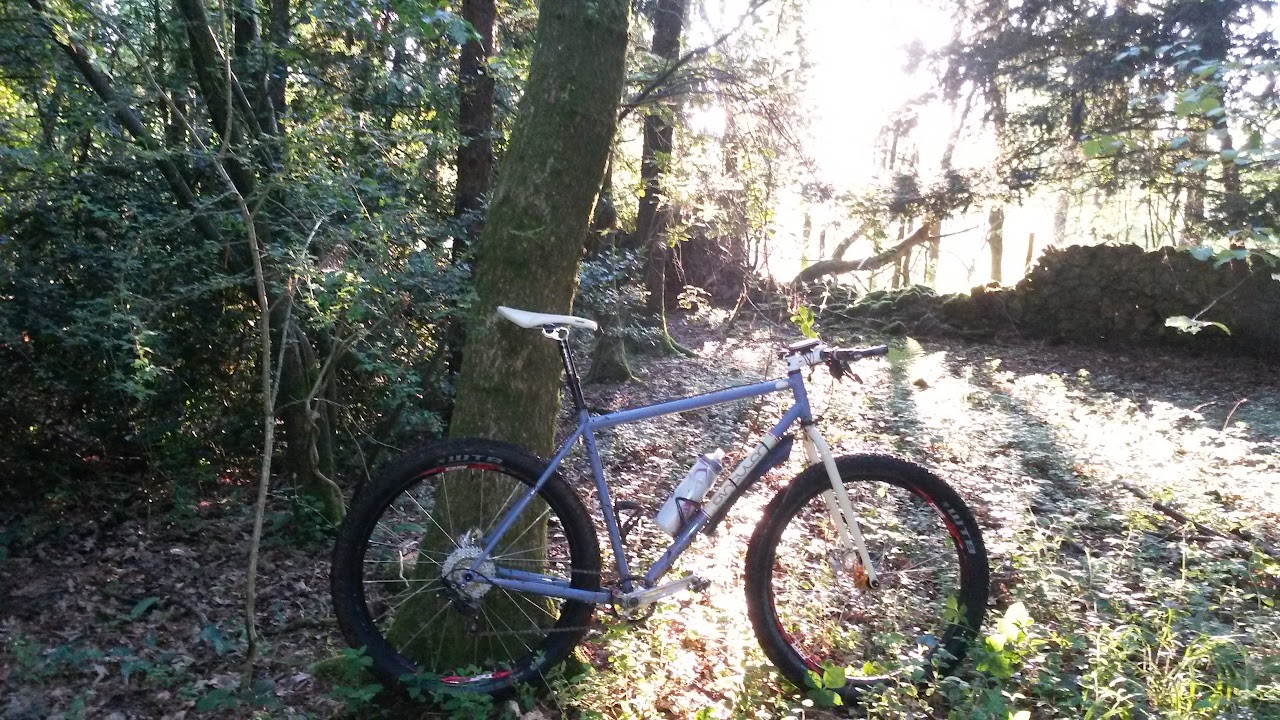

Singular Swift, original blue model with straight stays - the one with the least clearance as current models have more - but with the latest model of fork that will take pretty much anything up to 3.5" comfortably.
Rims - 650b Superstar Components DS25 - 30mm external, 25mm internal width, tubeless
Tyres - WTB Trailblazer 650b 2.8"
The tyres are 63.5mm at their widest point which easily fits my frame/fork combination. The pic is of the front wheel in the back of the frame but it's enough to show that it'll work (I haven't built the back wheel yet).
[img] https://lh3.googleusercontent.com/HNNBCMjZ2986otLKUnhunMyXK5UVbNyxlcOXPLEn5Kg=w1280-h720-no [/img]
(650b on the front, 29er at the back)

Posted : 19/06/2015 9:41 am

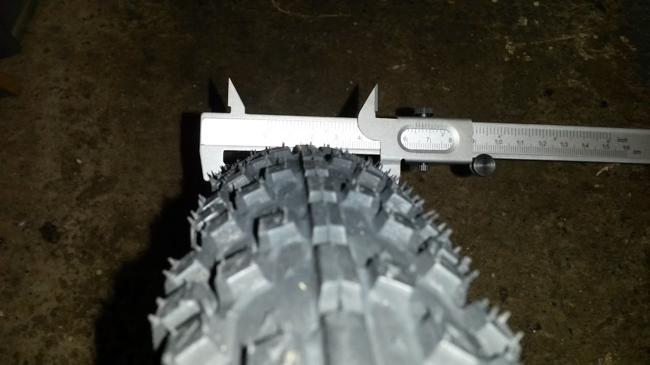

TB 2.8" on Pacenti DL31.
comes out at 64mm. PLenty of room in the back of an On-One Ti29er, and that's with tubular stays at the BB. Plate stays should give a ton of space.

Interestingly I'm pretty sure my old racing ralph 2.4" 29er tyres came out at 64mm too.
