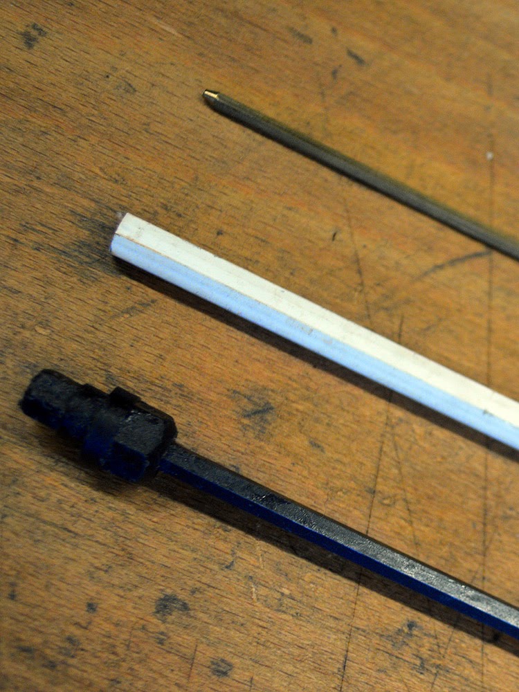

Some marzocchis have rebound adjust inside the bottom of the lowers
I think this is yours
You need essentially a long hex key to adjust it & it does make a difference

Posts: 34451
Yeah 3mm looks right
http://marzocchiworkshop.blogspot.com/2014/06/making-adjustments-internally.html?m=1
My old Jr Ts needed the black tool

Posts: 107
yep, had a set of the 2004 ones, the top (brass) hex key was to adjust the rebound, it was very long
they were nice forks once set up though

I have just been looking at the manual for the 2002 MXC AIR that you kindly linked thanks Kimbers, It looks like I need a 3mm very long hex key (am I right in that it needs to be a 300mm length key) as once i deflate the forks and remove the 21mm covers and compress them its still a long way down through the rod to access the hex point? Its promising to hear that the rebound can be tuned via this method as they are still in good condition and I have tried them at different pressures and changed oil a while ago but still not getting the response I thought they were capable of.
