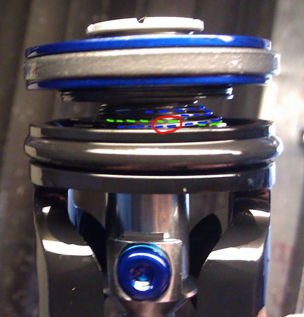

For the damping, you could check whether this was the problem:
(This is the 3rd time I've posted this recently in relation to RCT3 dampers)
http://forums.mtbr.com/shocks-suspension/3-rides-rock-shox-revelation-lockout-not-working-817103.html#post10333296
This was the cause of the lockout failing on my RCT3 Blutos after 3 or 4 rides. Very easy fix: just unscrew the damper and lift it part way out. Run your fingernail around the spring and if you hear it click into place above the shim, you've done it. Mine has been fine since (>12 months).

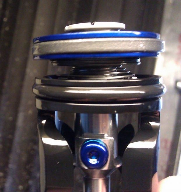

This is the photo from the MTBR thread:
What you're checking for is that the spring (dotted blue) isn't hooked under the shim (dotted green) like it is in the red circle here - the spring should sit completely on top of the shim and hold it shut.
You may have to turn the blue lever on the damper to fully open to be able to see this more clearly.
Running a fingernail around the spring is enough to peel the end of the spring back into the right place on top of the shim.
Not sure how you checked the oil volume, but it's worth checking the oil level is 71-77mm below the top of the leg, as quite a bit of oil gets trapped inside the rebound damper and doesn't always come out (need to cycle the damper a few times, at least). Too much oil could well cause damage when you start to use the forks in earnest.
