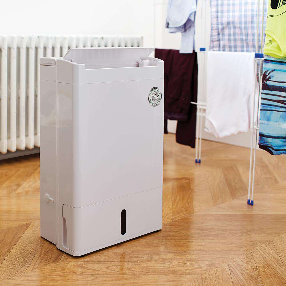

Im happy with my Meaco DD8l.  Most important thing for a shed is that you get the dessicated type not refrigerant type. Dessicated works at low temps.
With the Meaco you can either set a humidity level where it cuts out, a timer, or it stops when the container is full.
Hard to tell the running costs.  It will run more the First few days until the timbers dry out.
I think a 1l would be too small

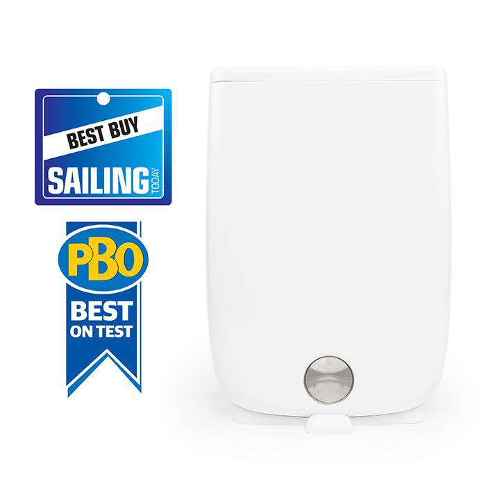

I have the  Meaco DD8 junior on my boat (37 ft x 12ft) so possibly double the volume of your shed.  Extracts 5l per day while living aboard in the winter.  Wouldn' want to be without it.
https://www.meaco.com/products/meaco-dd8l-junior-dehumidifier

I just bought the same Meaco dd8l junior everyone likes in December. But so far it managed about 2 days before conking out and just showing an error light, it's been a month now and still no replacement from the manufacturer.
I'm sure it works well enough, but their customer service has been a bit rubbish.
Bought from meacodehumidifiers.co.uk which it turns out isn't actually the same as the manufacturer.

Also worth bearing in mind how a dehumidifier works.
It is basically a refrigerator which attracts moisture by being the coldest thing in the room. Desiccant based units do operate differently but can be overwhelmed by operating outdoors, despite what this says -  https://www.meaco.com/collections/desiccant-dehumidifiers
In most sheds, metal objects (your bikes and power tools) are the coldest things in the room. Hence they attract moisture and eventually rust as a result. Other objects made of more absorbent materials such as fabric or wood tend to go mouldy. Even with a desiccant dehumidifier metal objects will still attract moisture.
A dehumidifier works well indoors where it doesn’t have to compete hard to be the coldest thing in the room. It is far less efficient in an out building because the air itself is cooler and more moisture laden and it is surrounded by stiff competition in the ‘who is the coldest’ rankings. When you introduce you entering the shed every now and again you suddenly bring more moisture and you are hot, so you offer no competition as the coldest thing in the room, but you do significantly add to the moisture level.
In short, your shed is a far from ideal place to run a dehumidifier efficiently. We have a Meco in our utility room that copes admirably and efficiently with taking the moisture out of the air when drying washing, but it is an otherwise warm and well sealed room. Meco are a pretty decent brand, but any dehumidifier requires the right operating environment in which to work efficiently.
