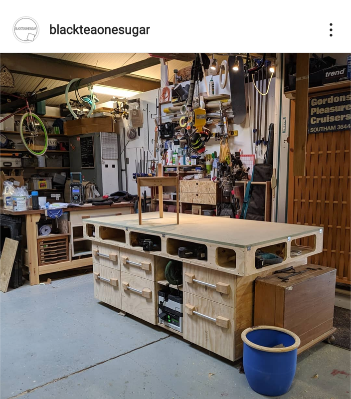

Posts: 18166
For a fixed bench, there are a ton of options.
I built my main work bench based on the idea of the 'Ron Paulk' bench (YouTube it) which uses a 'torsion box' structure, creating a really nice solid and flat top with under-top tool storage.
Here's mine.
I cannot over-emphasise the awesomeness of being able to sling your tools under the work surface as you work. So good for keeping it clear.
It also provides a really handy edge for clamping stuff down.
I built my whole bench out of shuttering ply and made big drawers underneath.
It's fantastic to be able to get to stuff quickly and put it away quickly.
It's 1x2m
Posted : 06/05/2022 8:29 am
Posts: 7869
Thanks @BigJohn 🙂
@Kayak23 that is am impressive setup. I had planned on large drawers but thats a great tip to just be able to put tools immediately below off the work-surface, cheers

Posts: 1467
@kayak23 cracking bench, may have to measure up how much space I have, if I make one of these to replace my very old school (literally) carpentry workbench, as I can get where you’re coming from with storing the tools right underneath where you’re working.
I’m always moving the tools out of the way, I’m not even sure how it happens, either they are in the way, or I put them out of the way and can’t find them!
Got any pointers re the table, I see yours doesn’t have the obligatory dot matrix board on the top ?
