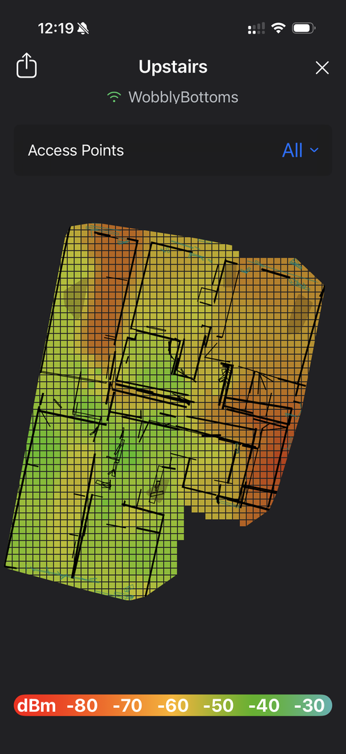

Posts: 2134
I went from Tenda MW6 (which was fine until it wasnt) to Ubiquiti Unifi. Unifi is night and day better. whereas with the cheap mesh systems you are expected to just deploy devices around the house and hope for the best, with Unifi you can use the planning tool to design an implementation then once youve deployed it you can use the signal strength tool to actually survey the signal strength around the house.
our house is 3500 square feet, 6 beds, with a solid wall down its spine and 14 tons of steel in its construction so a Wifi nightmare - im running an AP in the loft and one on the ceiling in the living room and that gives solid performance for 6 of us, 2 working from home and 4 teens with all the devices that entails. the power of the APs is configured so that they dont interfere with each other or my neighbours and having used the WiFi signal strength tool, I know I have better than -40dBm everywhere it counts and I know where it drops to -70dBm in the front porch, I know I can solve that with an inexpensive AP there if I ever want to use a doorbell camera etc. I expected to need at least twice as many APs
how big is your house to need as many discs as you currently have? could it be that theyre actually conflicting with each other?

Posts: 2134
here's an example of the Ubiquiti signal strength survey - thats a quick wander round upstairs with an iPhone - it uses the camera to draw in walls so you get a really clear image of any problem areas. this is all served by a single U6Pro in the loft fairly centrally. I know ive got an amber zone in the north west bedroom (that wall is a former external wall) but my son has never complained about WiFi quality. if I wanted to improve it I could move the attic AP and re-test or I could add one of the small in-wall APs in that bedroom. the main point is, you can fix issues based on actual evidence rather than just flooding the zone with more devices. IMG_0324.png
