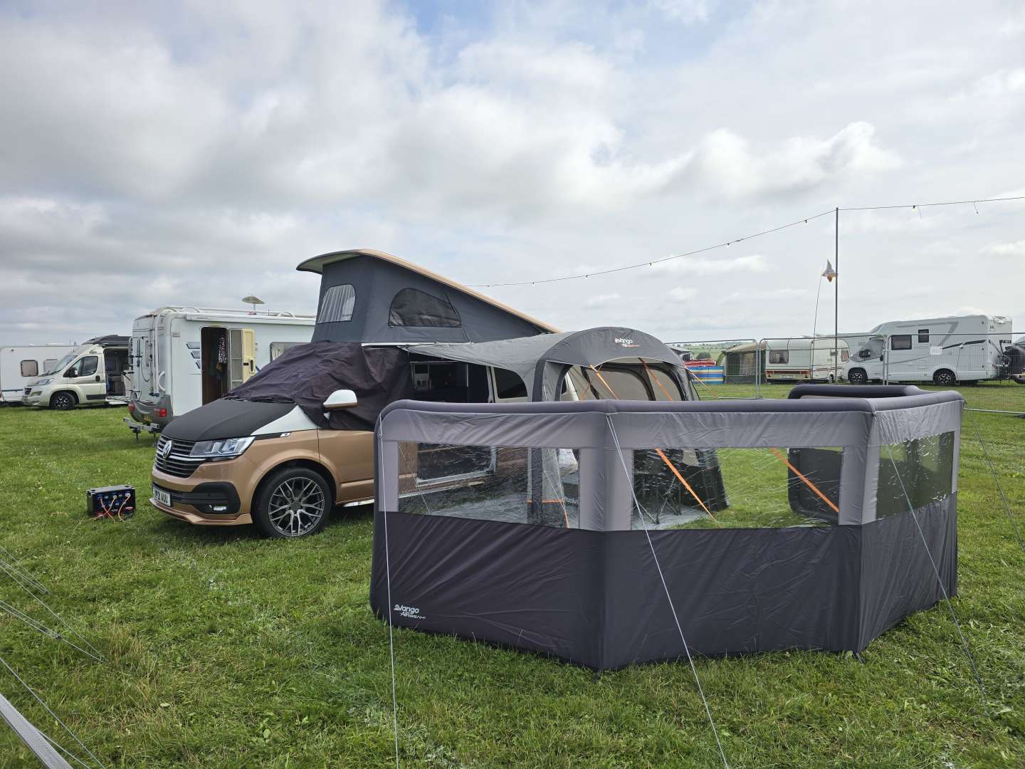

We have a simple sunshade (I dislike wind-out awnings) that slots in to a C section rail and massive (it's huge when packed up) inflatable driveaway awning thing that someone gave to us.  The drive away awning barely comes down from the roof space.

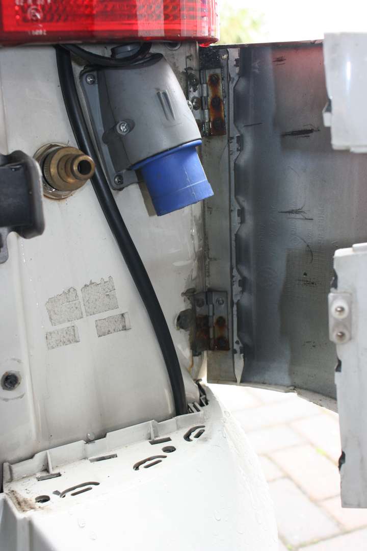

An example of your comment about clever stuff: they located the 240v hookup socket and water fill point behind the panel below the offside rear light on our T5, making it into a hinged panel. Meant no extra holes etc cut into the side of the van.
I miss that van, badly.

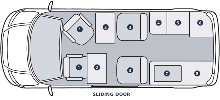

I reckon it's possible with the layout overview I posted above. Beds in that case use the single rear seats plus the front seat bases. Do without the offside furniture (items 4, 5 & 6), have bikes fork-mounted with front wheels out, bars turned or top n tailed. The single rear seats in that design look to be a similar distance behind the front seats as my factory Transit Custom L2 double-cab which I can fit bikes in lengthways with front wheel off.

RE layout: Bilbo's do a Space which intrigues me. We have a Komba with a similar ready for outdoor sports' approach to the interior and it all the brilliants.
https://www.bilbos.com/bilbos-campervans/space/
And of course the classic Nexa and Celex of similar layout.

My festival set up. Slept in in for a total of 8 hours from Thursday to Monday 😂
Posted : 07/08/2025 5:14 pm
