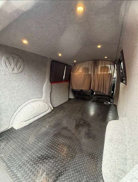

It currently has full insulation & carpeting in the rear including rear doors & roof but fairly lightweight curtains (not thermal or blackout) in both side windows and across the bulkhead opening to the cab. One rear side window is a slide opening but there isn't another opening window or vent in the rear, only the two front windows so I assume I need to do something to promote airflow in the rear especially if I want to fit a thermal covering on the front windows/screen or a more substantial barrier to the cab area?

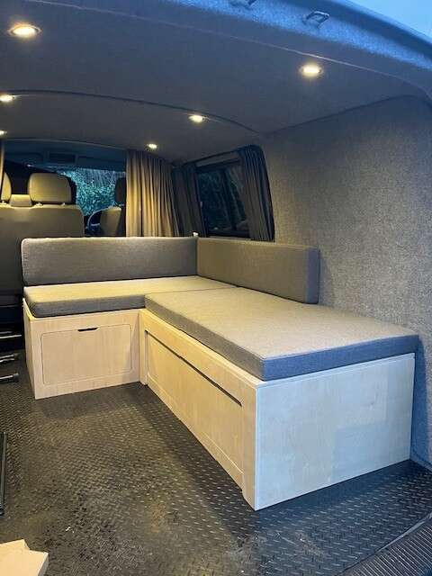

PFA of the blank canvas, I already have an L-shaped pull-out bed to go behind the seats/down the drivers side so I'll have storage space under that which can be utilised:

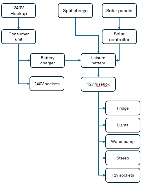

For weekends away with no hookup, given you've already got the hookup and consumer unit, you could run a battery charger off it and wire that to a leisure battery (or batteries). Plug in at home to get the batteries fully charged and then run off them whilst you're away. A 110aH leisure battery would last us a weekend running a compressor fridge, lights, water pump etc. If you hooked up two batteries you'd be laughing.
Our set up was (it started with split charge and a leisure battery, then I progressively added hookup and solar):
