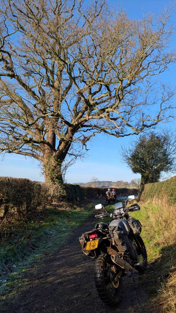

Staffordshire t'other weekend. The little back roads were lethal with black ice. The Byways by comparison were lovely and grippy.
