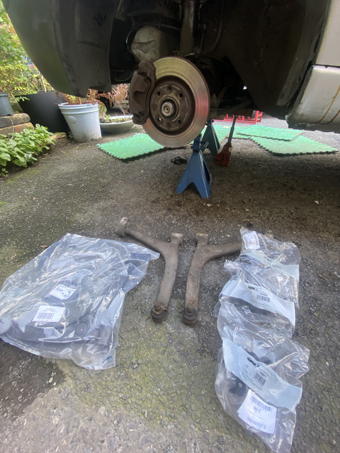

IMG_4614.jpeg  IMG_4613.jpeg Not very exciting post but 5k oil change today in MrsRNP’s 958. Also doing the fuel filter @ 5k mile intervals rather than the 10k VAG service interval. The high pressure fuel pump is vulnerable on the 3.0tdi and if it fails it sends shrapnel through the injectors and back into the fuel tank hence keeping an eye on it every 5k. A Mann filter (OEM) is £20 so it’s a low cost to keep in front of potentially writing the car off.
With the £500 XC90 I’ve cleaned and regreased all the driveshafts/CV’s. New GKN Lobro (OEM) boots fitted.
New SKF wheel bearings x4 (Volvo started life as a subsidiary of SKF bearings)
New Lemforder front control arms
Primed the top coated with Jotun.

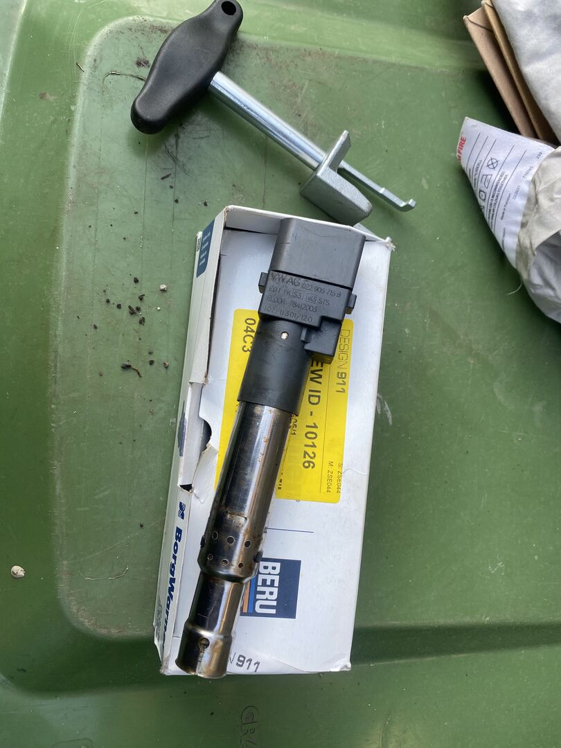

The £500 Cayenne let me down this week….work colleague Sam who was the previous long term owner of the car and the guy who sold it me (and regretted it immediately) was leaving today for pastures new.
I wanted to give him a final send off in it but on bank holiday Monday it threw a P0306 code for cylinder 6 misfire and was clearly not happy. Ordered a Beru (OEM) replacement for £27. Fitted tonight and it’s running well again.
The coil packs are all originals so can’t complain at 178k miles and 21years old. Should probably have ordered a full set but in the theme of bangernomics it just got the one. If another fails I’ll change all of them.

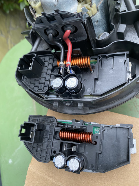

Posts: 6699
Small update for anyone interested in DIY maintaining a 958 Cayenne (the second bargain Cayenne I bought exactly a year ago).
MrsRNP complained that the aircon wasn’t very cold and might need ‘regassing’. I had a look and figured out the blower motor resistor had failed as the fan didnt go above setting 4.
The complete fan from Porsche is £1031, OEM is Bosch but you can only buy the left hand drive variant. RHD drive fan units are only available from aftermarket. I went with the ‘OE matching’ resistor from Design 911 for £65.
The fan is fairly easy to remove from behind the glovebox, once removed stripped the unit down, cleaned, oiled the bearings, new resistor and reassembled. I removed the Febi cabin filter the Porsche independent installed just before I bought the car and installed an OEM Mann filter instead.
Result is ice cold mega blast aircon again when you press the ‘AC MAX’ button and one happy MrsRNP!

Posts: 3731
I keep reading this thread and thinking a £500 is a great idea.
Then read
And
And decide yet again I haven't got the skills to diagnose and fix any car.
Great job RNP for stopping me buying something I can't afford to.fix.😃
Posted : 16/06/2026 5:38 am
Posts: 6699
@tall_martin
I think the reason I started this thread is to show pretty much the opposite - in that it’s not particularly difficult looking after cars and that my pair of Porsche’s are DIYable despite being a premium brand. Both my 955 and the 958 are better supported information wise than my old simple Peugeot Partner.
Pelican Parts of America produce clear concise YouTube repair videos, the full 9000+ pages factory workshop manuals are available FOC online, and there’s lot of cross referencing so you don’t need to buy Porsche main dealer parts.
All my Porsche tinkering is done outside (my £500 Volvo is inside) using basic hand tools.
Admittedly I bought both Porsches cheap from work colleagues but as a result I have two fantastic cars* for £6k and over the years I’ve saved £10xthousands in PCP/garage costs by DIYing
*I know these cars are ICE dinosaurs, a BMW i3 will be in my not so distant future.
Posted : 16/06/2026 6:17 am

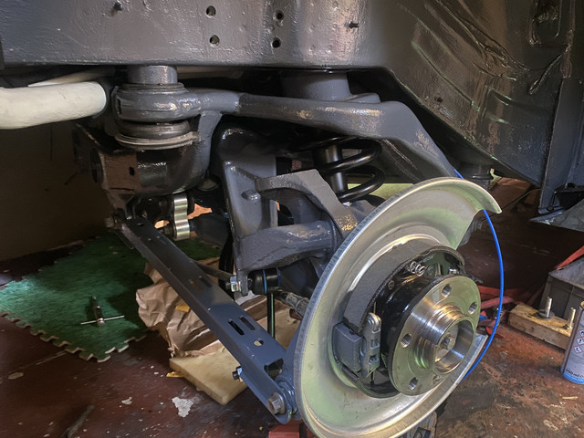

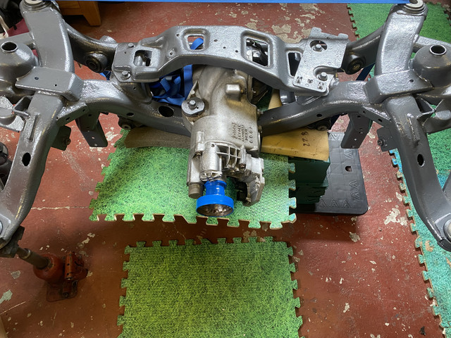

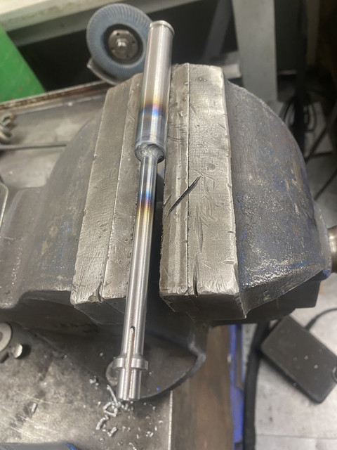

Posts: 6699
My £500 Volvo on the other hand ?………
This is probably beyond the scope of most STWers but I then might have got carried away!
The rear subframe/differential/Haldex unit is now reassembled and back in the car.
The differential was stripped because of the common failure worn front pinion bearing. Timken bearings and Corteco seals (OEM) used in its rebuild. The Haldex unit was fully stripped and cleaned. New seals and filter unit.
The subframe got all new genuine / OEM parts including subframe bushes, shocks, springs, complete handbrake mechanism, bearings, seals etc.
All surfaces cleaned, any trace of rust removed and lots of Jotun marine spec coatings applied.
Note the blue fuel line - I drilled and tapped the auxiliary fuel port when the fuel tank was removed so I can fit an Eberspacher heater.
The Volvo handbrake shoe springs are difficult so I made a tool at work to make it easier.
Financially worthwhile = no!
Better than scrapping / landfill = yes
Posted : 16/06/2026 6:26 am
