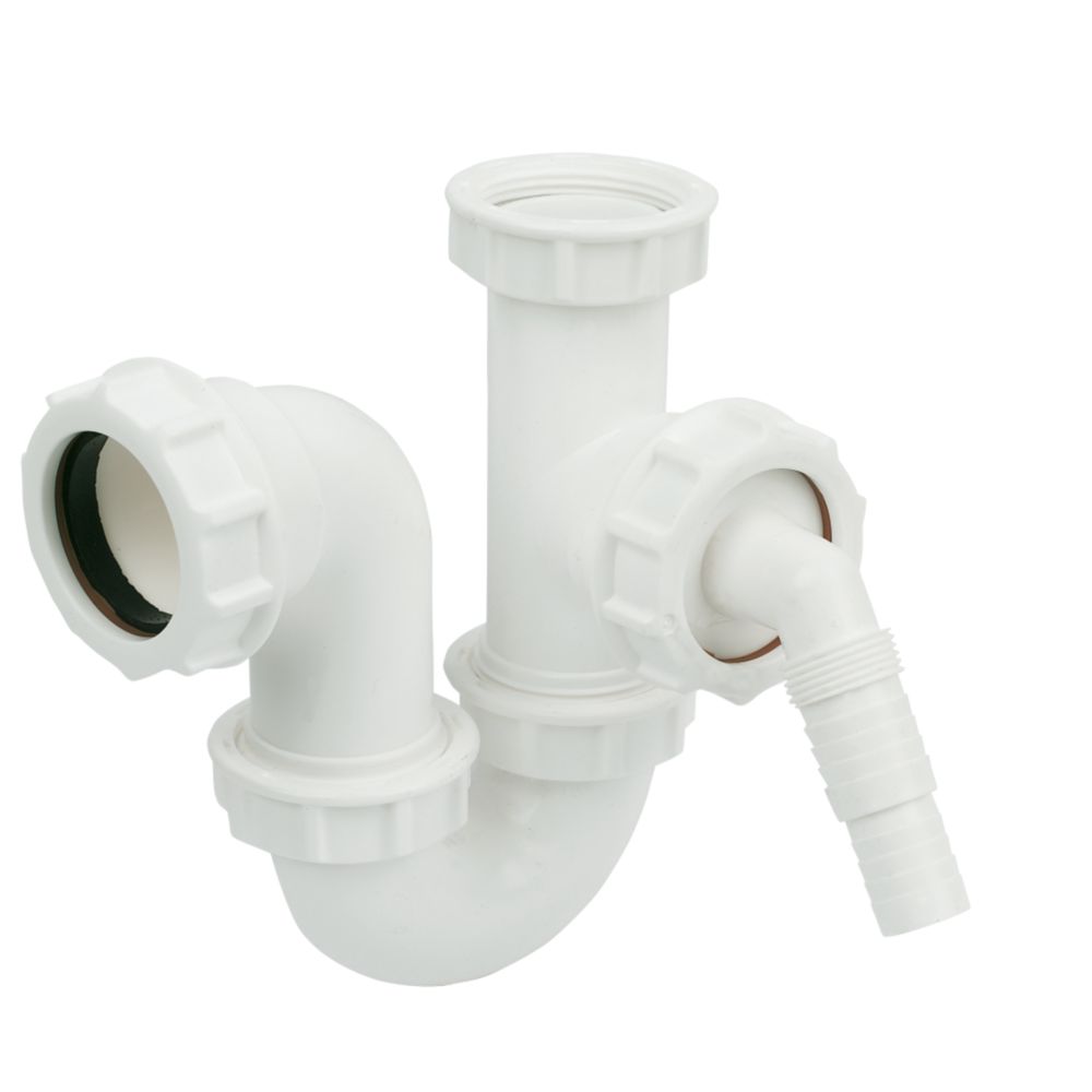

I fit a dishwasher at weekend, unfortunately due to length of waste pipe and the, ahem, previous administration's plumbing work I'm getting "backwash" from the sink into the dishwasher, (setup is a bit like [url= http://s7g3.scene7.com/is/image/ae235?$p$&layer=0&size=281,281&layer=1&size=281,281&src=ae235/12794_P ]this[/url] but the u bend outlet is slightly higher still). I, figure the easiest way is getting an inline "none return valve" ([url= http://www.homebase.co.uk/en/static/how-to-install-a-dishwasher-or-washing-machine ]see 7.3 here[/url]) for the dishwasher waste pipe but I'm having difficulty finding one. Any ideas? The proper name for them may help.
Next options are fitting a longer hose and raising it higher than ubend outlet or mucking about with the Ubend/sink plumbing, would prefer the valve tho.

Mine has a non return valve fitted to the 'stem' you connect the dishwasher waste too in your pic, so you could buy a complete trap and use that.
Or do what everyone else in B&Q had done which was tear open the pack and nick just that bit - took me a visit to PlumbBase to find a complete one!

Checking the screwfix site I could get [url= http://www.screwfix.com/p/sink-washing-machine-trap-40mm/12794?cm_sp=Search-_-SearchRec-_-Area1&_requestid=129422#_=p ]this[/url] but it doesn't say whether it has a valve
or [url= http://www.screwfix.com/p/plastic-outlet-hose-connector-17-x-17mm/37103 ]this[/url] and [url= http://www.screwfix.com/p/washing-machine-drain-hose-1-5m/78930 ]this[/url] to extend the waste pipe and make a loop (n-bend?) higher than the ubend?
