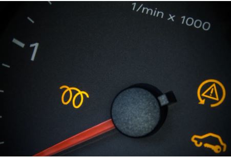

Car is hardly being driven at all at the moment and never over 60 mph. EGR?
Posted : 30/10/2020 4:25 pm
This one?
if so -
https://www.yourmechanic.com/article/is-it-safe-to-drive-with-the-glow-plug-light-on
Posted : 30/10/2020 4:30 pm
Posts: 5807
On briefly when you start means your glowplugs are active, on while the engine's running means there's a fault.
Posted : 30/10/2020 4:33 pm
Posts: 10980
Yes that one. Car went into limp-home so I drove it to an independent who told me it was mouse damage and showed me a horrible pic of two chewed vacuum hoses. When I checked under the cover this morning there was plenty of mouse damage but no new hoses and none that looked like the photo. So I'll be nipping back for a word next time I'm in town.
The annoying bit is that that's an hour's drive now instead of 10 minutes up the road and a quick bike ride home as it was in Lancashire so it means taking two cars. How I'm hating this, we've thrown away all the convenience of living near a town.
Anyone care to guess what the fault is?
Posted : 30/10/2020 4:40 pm
No idea, worse case is injector failure (mouse stuck in there!?)
Google “glow plug light Passat” and you should find owner forums with info.
Posted : 30/10/2020 5:05 pm
Posts: 91157
That coil light means an engine fault related to emissions. So it could be quite a few things related to emissions. On mine (2006) the turbo vanes are operated via vacuum, so you could easily get a boost issue via mice eating hoses. EGR valve is electrical, so that won't be hose related but there could equally be other wires chewed through. But you cannot guess, you need codes read.

I had this on a 1.9 tdi years ago, it was a failed glow plug. They can be found down the back on that engine so fiddly to change.
Posted : 30/10/2020 5:12 pm
Posts: 91157
Failed glow plug won't cause limp mode. My money's on turbo vanes.
What year is the car?

Posts: 10980
It's a 2016 2.0 tdi
