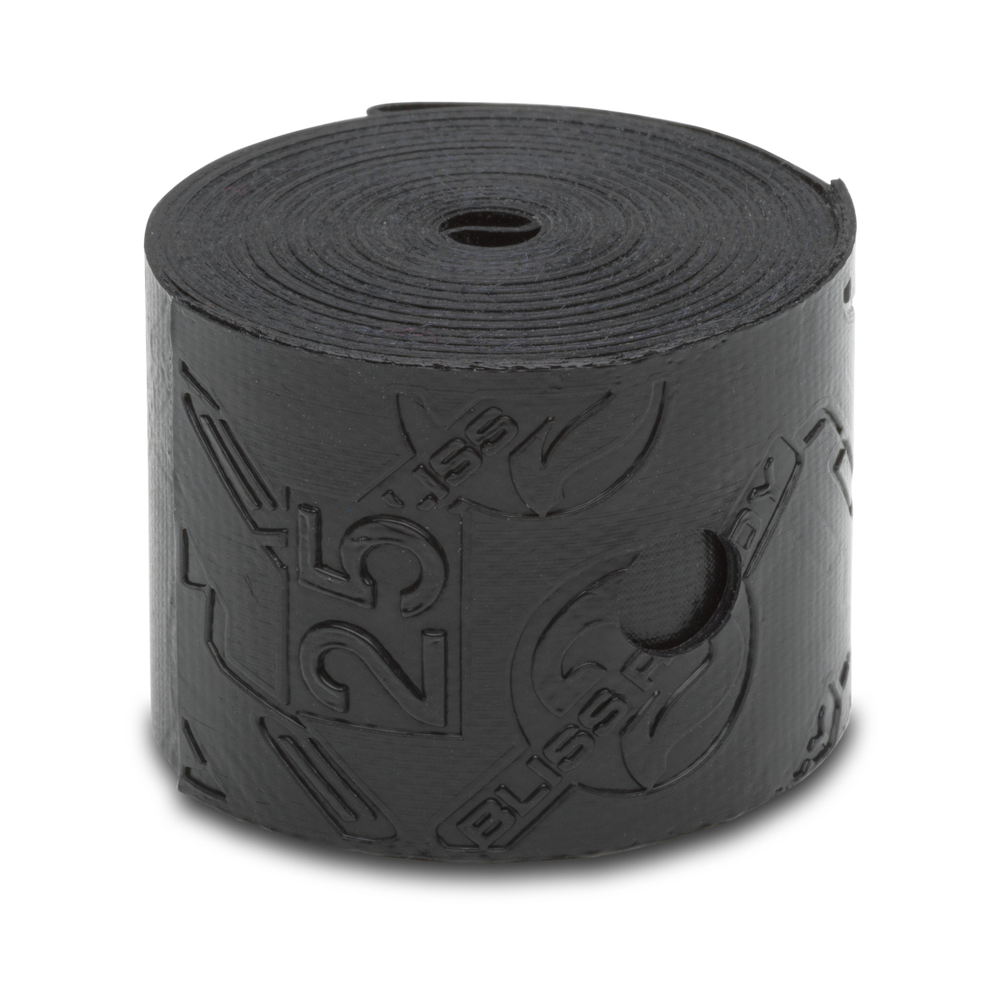

Posts: 2300
Buy some Spesh 2Bliss ready rim strips, that way you can just remove and refit whenever needed
I've been running them on two bikes for years now
https://www.specialized.com/lt/en/2bliss-ready-rim-strip/p/155405?color=229224-155405
