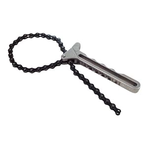

chain type here - no issues but it depends on filter design .
[img] ?_v=6e29fa4e-1b5b-4764-9f4a-593f3b4f9684[/img]
use these at work sometimes instead of the pipe wrench chain type - these have much bigger surface area
what didnt you like about the chain type ?
also certain cars have a profile on the bottom of their filters and you can get a socket to fit them !

Just found the chain type i had similar in design to a cassette chain whip could never get tight enough.
Any opinion on this style?
http://m.ebay.co.uk/itm/380444367999?nav=SEARCH
Cars a Vectra, filter close to down pipe, not a lot of room and pointing down at an angle.
Posted : 20/02/2014 10:35 pm

we also repurpose these at work for stubborns - they are supposed to be for spinning pipe up.
in my personal tool box i have the above - it works fine , fit it then the camming action of pushing away from the side the chain comes through tightens the chain and gives you the grip you need.
