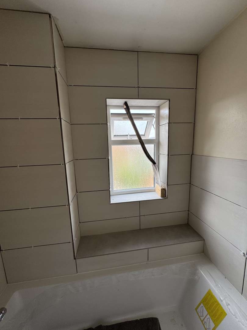

Posts: 5360
I'm finally ready to grout, is there any prep I need to do first?
Posted : 02/05/2025 8:34 am

At points of flex like tray to wall silicone deep in the joint before grouting.
Posted : 02/05/2025 11:19 am
Posts: 4464
Nope.  Tray should have been siliconed to the wall before tiling, then siliconed again after around the base and internal corners.
before grouting, just make sure joints are clear and everything is as clean as you can.  Don’t grout the internal corner joints or the joint between tray and tile, keep that empty for the silicone.
Posted : 02/05/2025 11:37 am
Posts: 18573
That's exactly what I'm saying in reply to the OP's question two posts above mine about what to do before tiling/grouting. If I think everything is pretty solid and unlikely to flex I finish the joint with grout. The main thing is to have silicone deep in the joint to stop water seeping through even if the grout does crack. Each to his own eh. A brick wall and concrete floor with a ceramic shower base is not going to budge. Other combinations are more likely to flex and need a silicone joint.
Posted : 02/05/2025 11:50 am
Posts: 5360
The bath is siliconed already.
I’ve just to grout between the tiles.
Posted : 02/05/2025 11:55 am
Posts: 18573
Looks good, I can't think of anything beyond choosing the colour of the grout. 🙂
