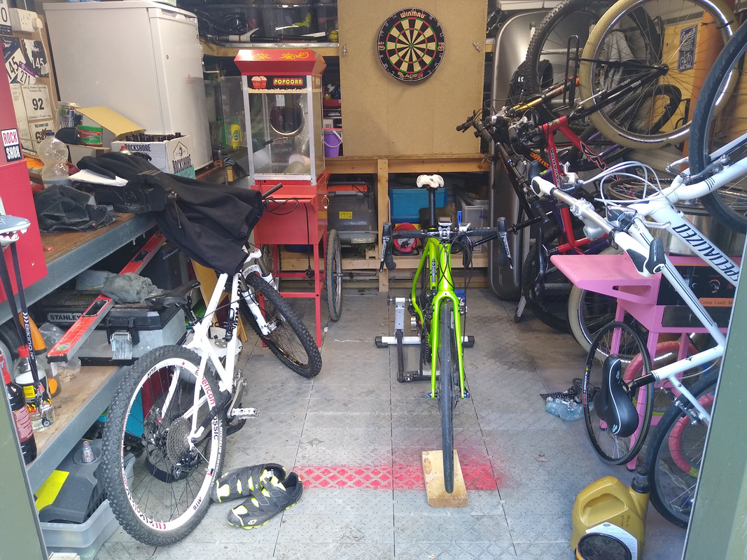

I've a big metal shed, 3x4.5m with just a roller door (agricultural standard).
It's great, I specced a flock roof so there is no condensation drip (my previous metal shed didn't and it rained in there).
It's pvc coated and 5 years old and looks brand new, dry, spacious and I'm very happy with it.
I can't store cloth as it'll get mildew but for bikes/tools/wood (popcorn & candyfloss machines) it's great.
Mine was on a par cost wise with a wooden shed, came with a free bench and gutters, made the shelving with about 200 quid of wood

No, it's pure condensation as the air mass keeps the internals of the shed warmer so the cold walls/roof at night allows the moisture in the air to condense.
I had a yardmaster cheap Argos metal shed previous to this one and it was like it was raining at times on a windy clear sky night.
This still gets condensation but the flock roof means it never forms drips.
There is a laptop for zwift, a stereo, larder fridge and a load of power tools all fine. I have Halfords roller drawers and massive socket sets all in perfect condition.
I'm in Ireland (wooden sheds are a piss take cost wise, made out of tissue paper or ok and a fortune) and got it from Adman metal sheds (it's a durastore). I'm sure there are equivalents in the UK.
