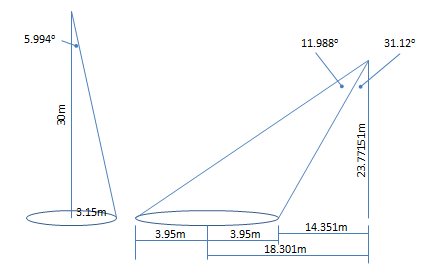

OK....I have a theoretical light positioned shining vertically downwards at a height of 30 metres and the beam angle creates a spot diameter of 6.3 metres.
I need to create an elliptical spot, maintaining 6.3m along the shortest axis and a the longer axis needs to be 7.9m. The distance from the light to the centre of the ellipse needs to remain at 30m.
What's the formula for working out the angle at which the light should be tilted to create this ellipse?
I'm knackered and now my head hurts...
Enlighten me?

OK, centre line of beam should be 37.114deg from the vertical.
The long axis of the ellipse will start 14.351m horizontally from a point directly underneath the lamp.
The long axis ellipse will finish 22.251m horizontally from the same point.
The centre point of that axis will be 30m from the lamp.
Posted : 27/05/2009 12:52 pm

Like this:
Posted : 27/05/2009 1:10 pm
Cheers -m- 😀
So the hyp on the elliptical diagram is 30 metres (centre line of the beam). I can't see how you calculated the lengths of the two other sides (23.7m and 18.3m) as you have no values for the angles other than the 5.994 half beam to get the longest axis when the light is vertical.
[Sorry if it's obvious]
Posted : 27/05/2009 1:36 pm
Should the radius of the spot on the left-hand diagram not be 3.15m?
Posted : 27/05/2009 1:40 pm
 -m-
Posts: 697
Yes, well spotted (now fixed).
For the above solution the centre line of the beam isn't the middle of the ellipse. Instead, the lamp is 30m from the centre point of the long axis of the ellipse. As lots of people have said above, the two aren't the same.The centre line will actually fall to the right of the centre of the long axis of the ellipse (about 30cm further to the right).
I'd suggest you ask DrJ for his solution as it looks very elegant!
Mine was a bit brute force; simultaneous equations involving the height and angle between vertical and centre-line of beam - one based on the triangle of the beam, the second on the right-angled triangle created by the 31.12deg angle.
