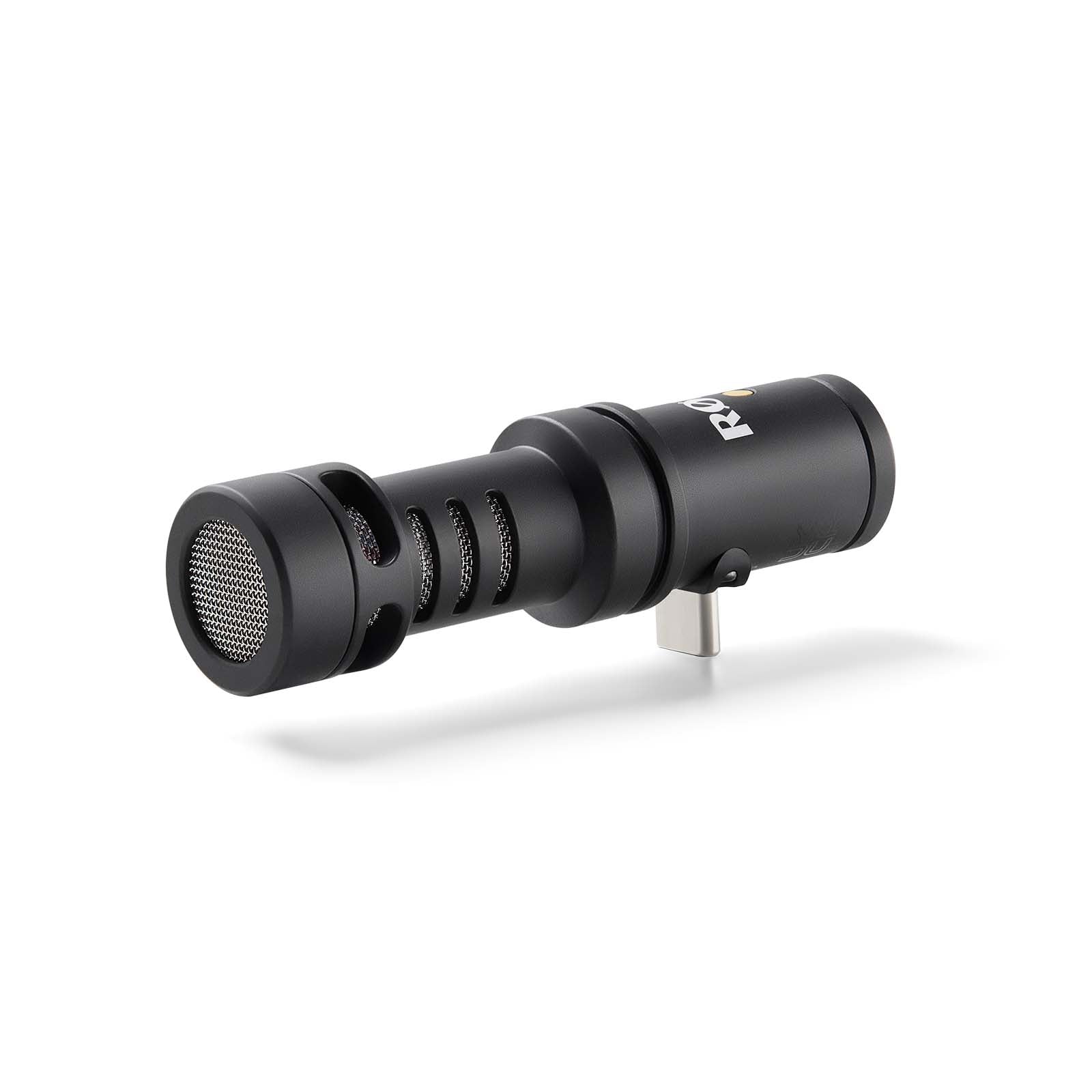

I’m off to Goodwood FoS this year and would like to improve the audio recording for the event, loud and throaty engines, to enjoy with headphones at a later date.
The current thought process is;
I have a GoPro Hero 8. Maybe a media mod add on, which has a better microphone.
iPhone 15 pro with an external microphone, say something like this….
https://www.wexphotovideo.com/rode-videomic-me-c-3194974/?cpgnid=18007676301&adext=&account=853-353-2386&campaign=&group=&mkwid=_dc&pcrid=&kword=&match=&plid=&pgrid=&ptaid=&si=&gad_source=1&gad_campaignid=17336452485&gbraid=0AAAAAD6dWBfyg6bKSIpyBPgPd9bdhXS95&gclid=EAIaIQobChMIor_C3t-TlQMVQZRQBh0j2SUhEAQYAyABEgKPx_D_BwE
I’ve also got a
Sony Cyber-shot DSC-HX20V
which takes great photos and video and has a decent zoom, but not sure how I’d get improve audio as it doesn’t have microphone input.
Any thoughts on what might be the best option, in a reasonable budget?

A crossed pair stereo mic sometimes an XY mic.
I would be wary of ones that usb into the base of a phone, you want the mics to be horizontal.
That will give you good stereo seperation of the cars zooming past.
Go cheap to start. But anything will be better than the mic behind the tiny hole in a phone or go pro.

If a microphone has Rode on it, then really you can’t go far wrong. I’ve got a pair of their NTH-100 headphones, and I see they’ve brought out a smaller NTH-50 version. They’re pro studio monitors, and are excellent quality and excellent value. I’ve lost count of the number of times I’ve seen presenters doing O/S broadcasting with a Røde microphone somewhere, easily identifiable by the ø logo, so if their products are good enough for national television broadcasters to use, then I’m sure they’ll perform well on a top-end iPhone.
Mostly this, you'll never make it sound like TV because TV production spends as much time and effort on sound as it does the pictures, they'll have microphones al over the place, all with different polar plots, cardioids, shotguns, omni's, etc that they mix in post production to give you the right effect.  The mic bolted to the top of the camera is really the last resort.  Your best option is probably just whatever Rode make that plugs into your camera.
