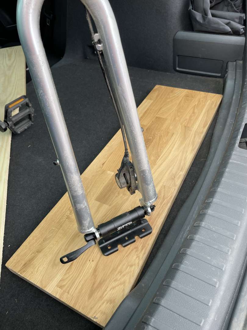

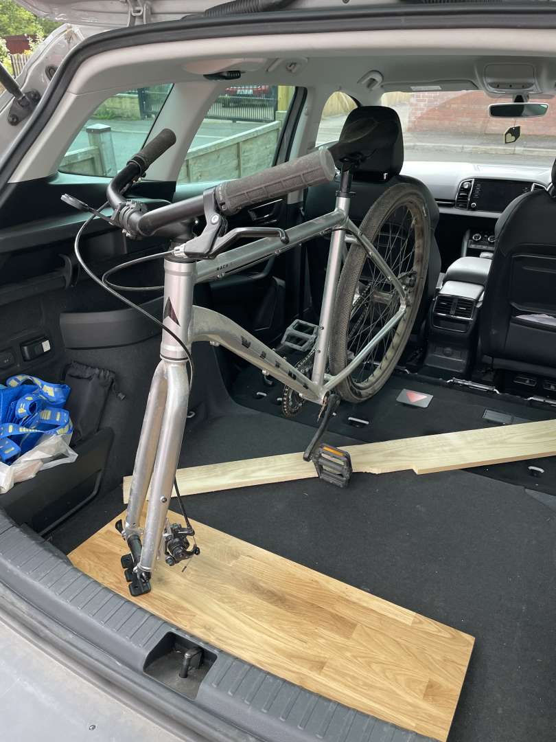

I’m just building up an internal cycle carrier in my car, and would appreciate ideas and suggestions how best to secure the base board to the boot lashing points, ie, to stop the whole thing sliding forward when I brake.   The board in the photo is for example, and will probably be a little thinner.
The simple solution perhaps is to get some thin and short ratchet straps and loop them round the lash point and then round the board?  Any idea for a more mechanical fixing method??

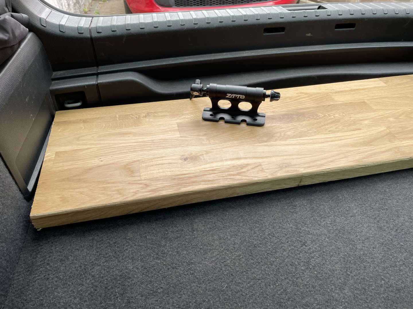

Posts: 3433
As pictured

Posts: 3739
If the plank was wider you could have put a cup hook at each end and hook them around the anchor points.
Or you could put strips of velcro on the bottom to grip the boot carpet. That might provide enough traction to stop the board from moving.
Looking at the last picture, and I'm sure you have already checked this, but does the boot lid close OK with the bars at that angle? From the image it looks like the left grip will be very close to the window.

Posts: 3273
The hook side of velcro on the bottom of the board would probably stop it moving *much*. I'm not sure lashing to fixing points would keep it that far back. Maybe some plastic clips that would sit over the boot lip, so when it's shut they get clamped down?

Posts: 9061
That is what I've done.  Not so much to stop a little sliding but due to my fear of what would happen should I crash

Posts: 3508
Velcro as mentioned.
Or..
Does the car have a false boot floor with a spare under it? If so why not fix the fork mount direct to it? It's going to be between 12-18mm thick, so sturdy enough. A couple of 6mm drill holes and nuts/bolts will be suffice. It can be left in at all times and if you sell, I reckon you'll not even notice its been drilled it you brush the pile

Posts: 3433
Velcro might work but I’d rather it was fastened in place.
Re the sizing, the boot does shut ok, the bike is as far to the back as it will go but there is probably scope to move it forwards a good four inch.

Posts: 6981
Strips of self-adhesive Velcro on the bottom would be fine - I used a piece of 4x2 with a couple of fork carriers for a few years

Posts: 3191
Just imagine how much it would hurt if a bicycle hit you on the back of the swede. Now have a good long think about a much more secure arrangement!
Posted : 07/06/2025 5:46 pm
Posts: 3433
The bikes should be secure.  There is a second pair of lashing points just behind the rear doors and I have a long ratchet strap which will go around the bottom of the seat tube and keep them from lunging forwards.
Posted : 07/06/2025 5:57 pm

Posts: 3433
Just checked, there is no false floor and the carpeted panel just lifts up easy so might ride up with the Velcro’d board.

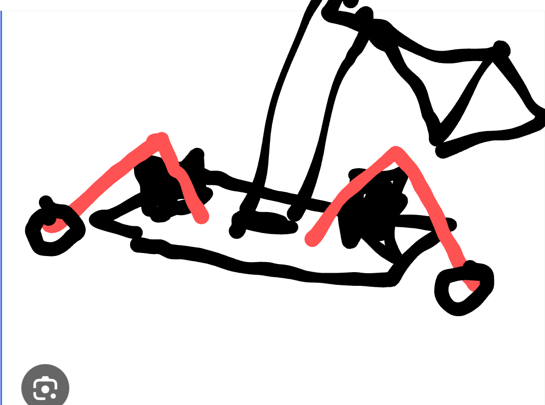

Posts: 18412
I would think lashing the board with ratchet straps would work albeit it would work better if you can take the straps upwards over a block or something, and then back down to your lashing points.
Otherwise you're pulling in a fairly flat plane which won't be as secure as if you can pull down and across.
A bit like in this AI render.

Posts: 9061
I saw on another thread people saying they missed Jamie but I think we've just found a replacement graphic artist.  What are you like at rainbows? 🤣

Posts: 3433
@kayak23s rendering has clarified exactly what I need to do. Wonderful visualisation.

Posts: 18412
Otherwise the way to do it is a bit like how you tie a motorcycle down.
Use a webbing strap going from the bars, down to your lashing points. One each side. Nice and high angle of pull then. With suspension forks you compress them slightly as you tighten.

Posts: 7386
Posted by: kayak23
This (although I'd use the stem rather than the 'bars) and another strap through the back wheel, running back to the rear lashing points.
