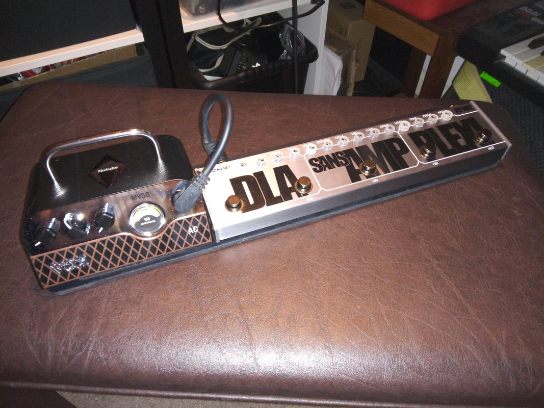

I've got two of the MV50s now ☺️ bought the MV50 AC + 8" cab bundle from DV247.
Been A-Bing the High Gain and the AC, and I think the AC is more to my taste, though the High Gain has a nice sound it's a bit heavy for most of what I play.
I've lent it to our singer/lead guitarist to have a play with, otherwise I'll probably sell it on.
They are amazing for their size. I've put it through a 4x12 (Vintage 30s), a 2x12 (GT12-75s), a 1x12 (70-80), and the 1x8 Vox...
...Great sound out of all of them 😎
The little Vox 8" cab is amazing too. Really big sound out of such a teeny cab. Would defo be enough for a small venue, with a little bit of the amp DI'd into the mix.
This my minimalist pedal board now...MV50 AC + Tech 21 Fly Rig (boost, plexi overdrive, reverb, tone, and delay). Can just go straight into a cab 😎
Posted : 29/06/2021 11:11 pm
Posts: 13282
Thats a sensible looking pub-gig pedal board. 👍🏼

Posts: 6311
Remember those Vox MV50 Amps we were talking about earlier in the thread?
Having bought the AC one, that gives a very good approximation of an AC30, but at manageable levels.
(I'm selling in the High Gain one, as it's too much for what I need.)
The tiny head unit + the 10" cab I built is more than loud enough for band practice with a drummer, another guitarist, and a base player who thinks he's Lemmy 😁
Defo worth trying out if you can find one.
