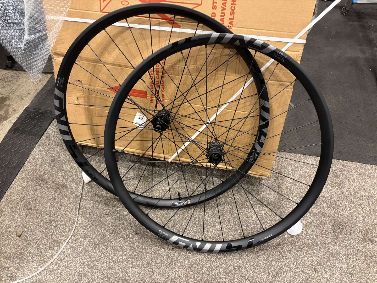

 a11y
Posts: 4120

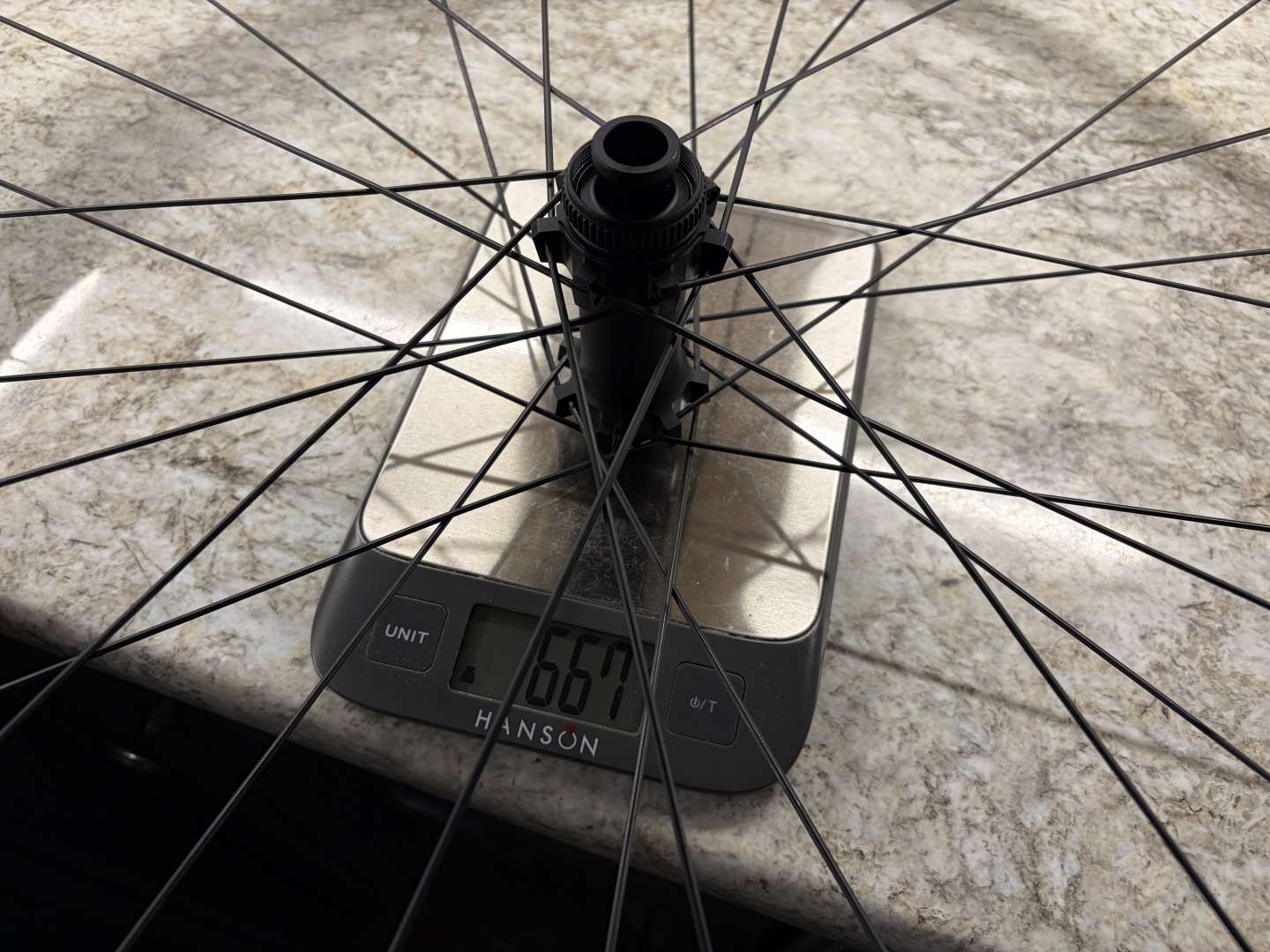

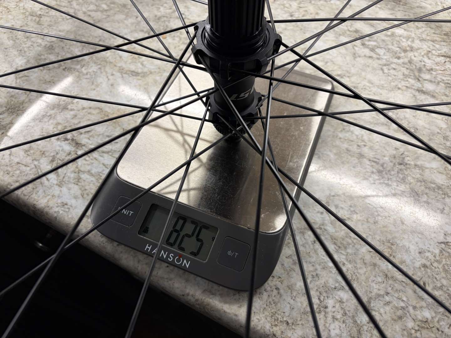

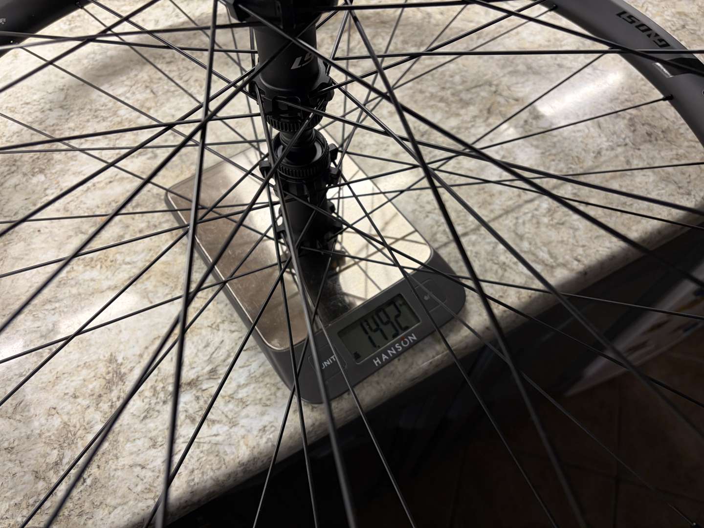

My weights: front 667g, rear 825g (microspline), pair 1,492g inc tape and valves on my kitchen scales.
The look and feel rather nice. Took me a while to realise the rim decals are indeed saying 'Ghost' (not as unclear as Scott's 'Turd' logo but not exactly clear...)
Posted : 08/01/2026 3:39 pm

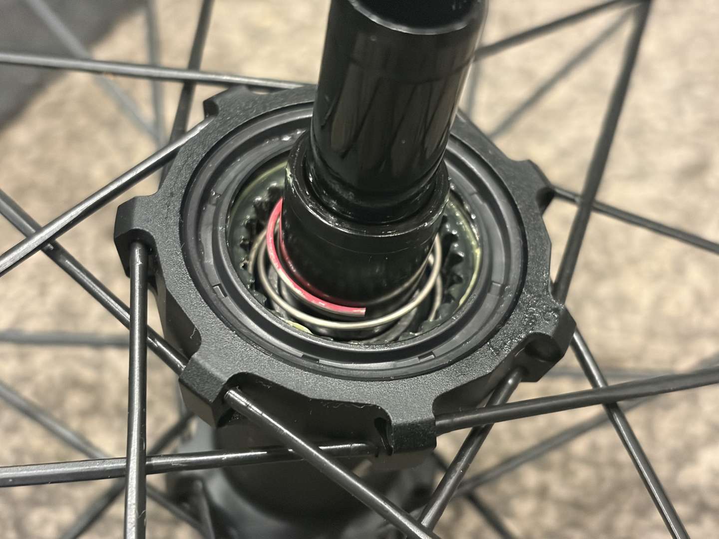

 a11y
Posts: 4120
Posted by: Stevelol
Update, fyi this morning I futzed around with a DT 370 LN ratchet HG freehub from my spare E1900 wheelset and it seems to work with the ghost freehub (XD freehub), I had to add a spacer between the 2 ratchet rings and the freehub or else the freehub would lock up, but it seems to work in the stand at least...

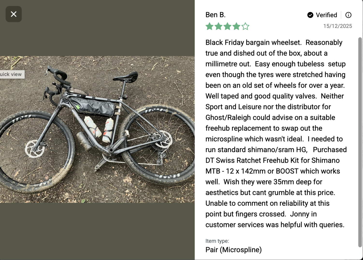

@Stevelol, did you do any further testing with your DT 370 LN ratchet freehub on the Ghost hub? I'm keen to make use of a stock of XD cassettes I have, so being able to replace the Microspline freehub would be great.
A review on the item page on Sport&Leisure has someone successfully using a 'DT Swiss Ratchet Freehub' kit to convert Microspline to HG. Whether they mean Ratchet or Ratchet LN, I don't know - apparently they very similar except freehub seal being attached to the hub shell on Ratchet vs attached to the freehub itself for Ratchet LN. You can't remember if a seal is present/visible on the Ghost hub shell?
Posted : 13/01/2026 4:49 pm
Posts: 1448
Hey, yeah the freehubs have different sealing.
I have a DT E1900 wheelset with an XD freehub, these are with 370LN hubs, I took my HG one off the Ghost wheels and swapped the XD one on, but the cassette would lock up when stopping pedalling/back pedalling, so I messed around and added a spacer/washer behind the freehub to allow the springs to move it out of the rachet mechanism when coasting/back pedalling.
I think I also had to mess around swapping the spacers as the ratchets are not exactly the same.
I ended up buying an 18mm one of these to use as a spacer which snaps onto the axle nicely, the size has to be right as it has to slide over the axle, but not be too baggy, but had a small enough outside diameter to still fit inside the rachets so they can be pushed out of the way by the springs.
https://www.ebay.co.uk/itm/113855730687?mkevt=1&mkpid=0&emsid=e11400.m144671.l197929&mkcid=7&ch=osgood&euid=9e122f37b197457299c56ebe27dd466d&bu=43096257755&osub=-1%7E1&crd=20251208064415&segname=11400
If you have both freehubs to hand and a bit of patience then you can probably get them to work. Had about 6 or 7 rides so far and no problems.
Posted : 13/01/2026 4:55 pm
 a11y

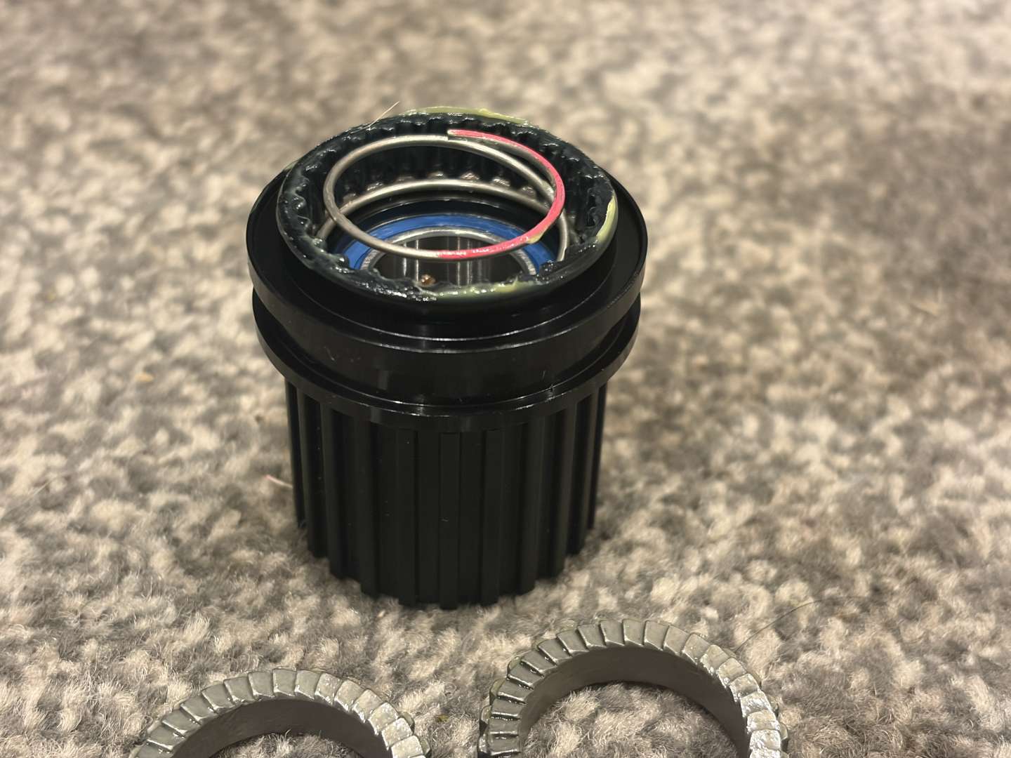

Posts: 4120
I was curious after posting the above so popped the freehub off the Ghost hub. The seal is on the hub shell rather than the freehub, suggesting Ratchet rather than Ratchet LN: https://www.dtswiss.com/en/wheels/wheels-technology/ratchet-technologies-overview
Does that sound correct?
I've been a Hope person to date and DT hubs are new to me, so I'll need to buy a freehub to play with it I want to experiment. Tempted.
EDIT: dammit, missed your reply @Stevelol. I'm confused now (easily done TBH) as that sounds the opposite to what you're using... 🤨
Posted : 13/01/2026 5:27 pm
Posts: 8273
Seal on hub shell it ratchet yes. If a ratchet LN freehub was fitted you'd be double sealed so not surprised it jammed.
@a11y I might have one a HG one you can have cheaply.
Posted : 13/01/2026 5:31 pm
 a11y
Posts: 4120
Thanks @nixie, unfortunately it's a XD freehub I need - I've got a couple of part used XD cassettes to use up after swapping my e-bike to LinkGlide.
DT hub tech is all new to me so thanks for confirming what I thought about it being Ratchet.
Just like this I think? https://www.bird.bike/product/dt-swiss-xd-freehub-body-for-ratchet-wheelsets/
Posted : 13/01/2026 5:37 pm
Posts: 8273
Yes one of those. That's a great price!
Posted : 13/01/2026 5:41 pm
a11y reacted
Posts: 4467
They are not DT Swiss hubs, the shape of the inside of the hub and the way the seal fits into the hub are both wrong.
They will be Far Eastern copies made since the DT ratchet patent expired so some DT parts may fit but many will not and DT will not be able to assist with compatibility issues as it's not one of their hubs.
If you want to be 100% sure then send the DT UK service center a shot of the rear hub's serial number and they'll be able to confirm.
Posted : 13/01/2026 5:49 pm
Posts: 8273
No one is suggesting they are DT hubs just that the parts may fit. My response was to indicate that seal on the body is the way DT ratchet (rather than ln) hubs are made so if trying parts you'd need ratchet parts.
FWIW when I had a wheel with a prime ratchet hub I tried the DT bits on the prime hub and prime bits on a DT hub and both ratchets and freehubs seemed to work both ways.
Posted : 13/01/2026 5:56 pm

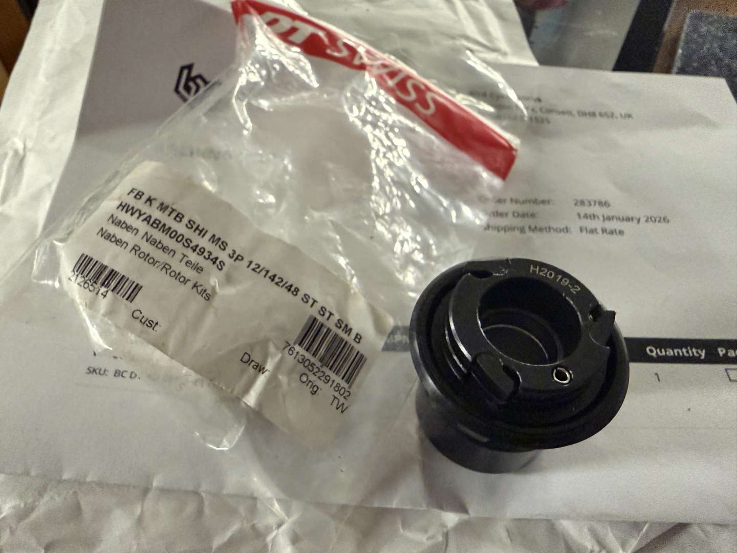

 a11y
Posts: 4120
Is this me not knowing my DT Swiss stuff, or have I been sent the wrong thing?!
I was expecting it to be the ratchet thing (with the ratchet teeth on the inside) given the description, not the 3-pawl version. Am I mistaken?
Posted : 15/01/2026 7:58 pm
Posts: 3307
Yes thats wrong. Part number on the bag is for a Shimano Microspline 3 pawl.
Is it a 3 pawl XD you received?
Give Bird a bell and they will fix that, usually pretty good sorting issues.
Posted : 15/01/2026 8:27 pm
 a11y
Posts: 4120
Thanks @rockthreegozy, it was indeed a 3 pawl XD I received (not the clearest in the picture). At the price I guess it was too good to be true! I'll give them a call in the morning.
