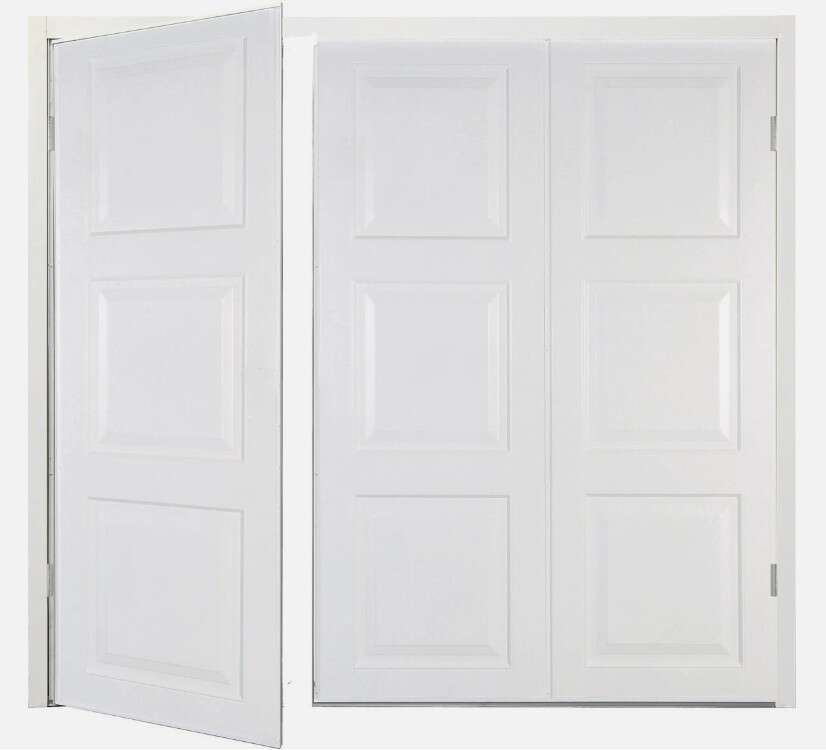

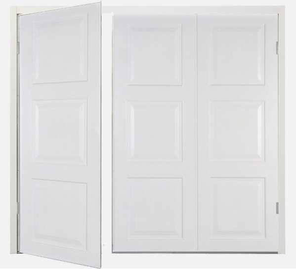

So I'm looking to replace my standard up & over with these 7ft x 7ft from Door King on eBay (which were recommended in a previous garage door thread) :
My current 'structural opening' (brick to brick) is 7ft tall by 8ft wide.
I can't re-use any of the frame from the up & over as it isn't solid box section on the sides, so need to make up the 6 inches either side to reduce the opening to 7ft.
I'm thinking 6x3 or 6x4 wooden posts either side - what grade timber do I need?
Links to appropriate products appreciated.
How should I prepare it - undercoat and decent exterior paint before I fix it in place?
Next question is how's going to be best to fix in place?
I'm thinking drill large dia hole into the first 3in of post and then smaller hole for the screw into the brickwork - so would be looking at something like a 6in screw into a 3in rawlplug in the brick.
Does the above sound reasonable or have I missed something glaringly obvious?
