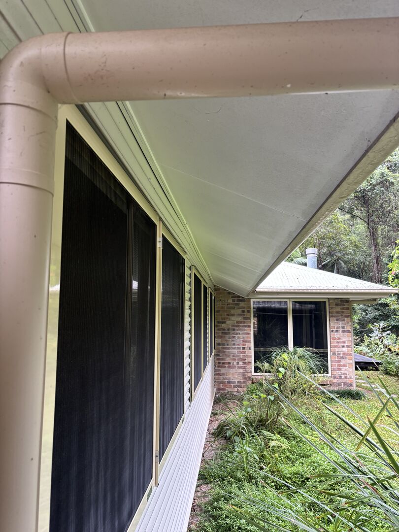

We fitted microlouvre to our house. A slightly different approach.
https://greenefire.com.au/app_prod_cat/microlouvre/

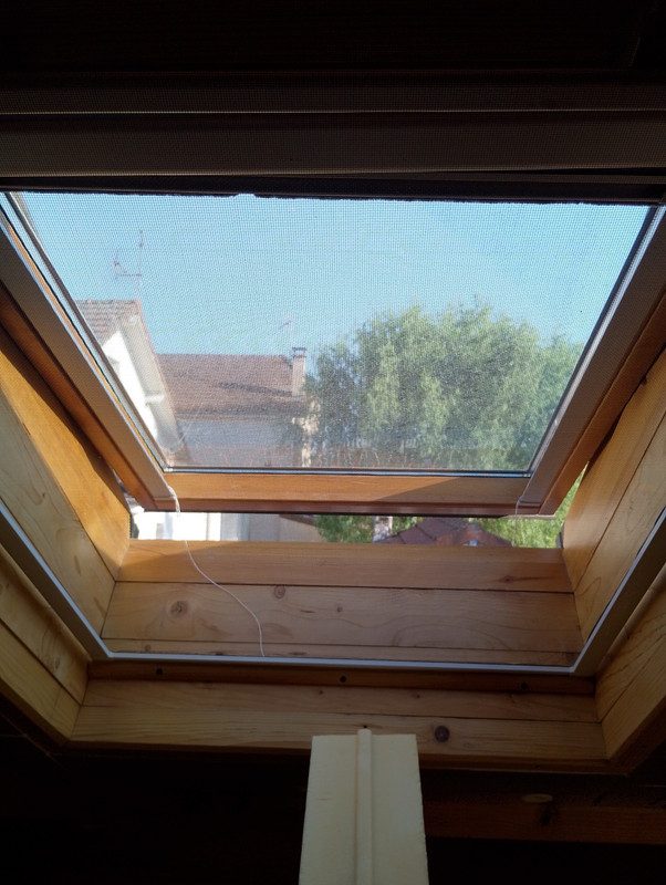

We have pertian type external shutters with mosquito nets on the  pertian parts so we can open the windows at night. The last few days that's got the temperature down to 24° in the morning and the house heats up to 26° late evening. Outside it's been 18-23 in the morning and 32-33 in the afternoon. In the Winter I board to epertian parts to improve insulation.
For the glass front door I've made up an external curtain and for the Velux I drape an aluminised camping mat over it.

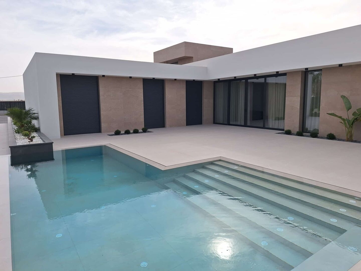

We’ve also got shutters on our patio doors and mesh, the shutters can be fully down or slightly up so it touches the floor but there are ventilation holes you can then have the door open with a mesh.
I was speaking to my m8 about this and reckon the cost for something like it in the U.K. would be pretty frightening but the Spanish prices were very very  good.
Sort of thing you’d ship over pre Brexit.
(Not DoDs actual house 🙂  )

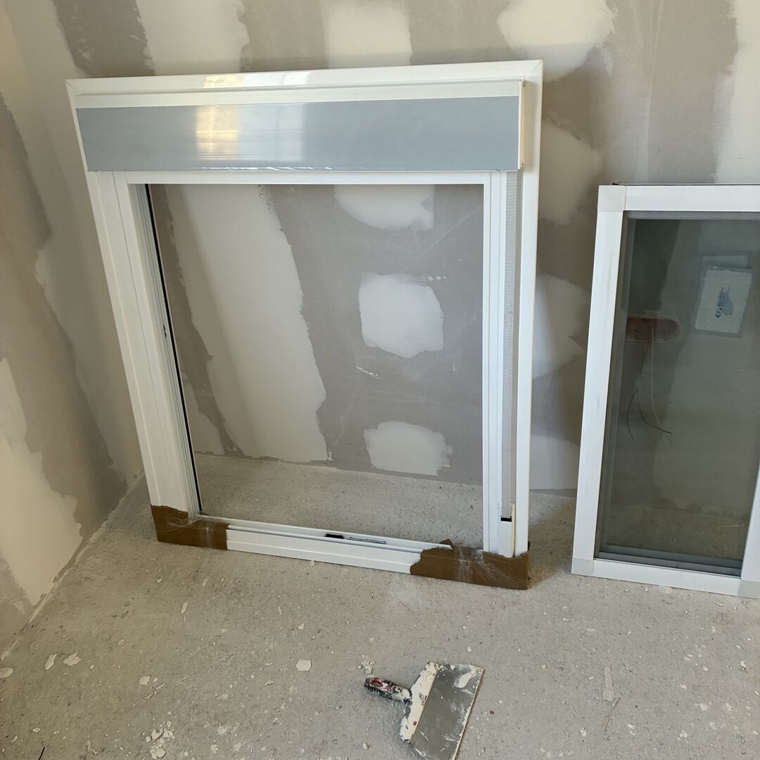

The Spanish ones (persianas)are part of the window frame unit and they tend to build the hole in the wall bigger on the inside than the outside.
The gray is protective plastic but you would see it as a panel above the window in the room side with the bit you pull to put it up or down on the side
Some have internal netting you can slide down or a slide .
Its sliding windows you can take out from inside with double glazed units
You can automate them as well , they are very common and well priced

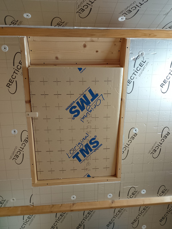

In th eday I leave the window open and put a chunk of 140mm polyurethane insulation in place. At night that gets repalced with a mosquito net. Given it's 34° this afternonn I think 27° inside is quite good.

We don't have a/c or heating in our place - a white roof, lots of insulation, overhanging eaves, high ceilings with dc fans and microlouvre (keeps the heat out but still allows light in, which blinds and shutters don't do). We don't even have double glazing apart from one room that is least shaded.
