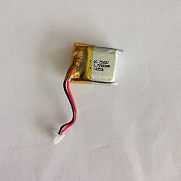

The battery in the quad looks kind of proprietary, similar to this;

[quote=verses ]The battery in the quad looks kind of proprietary, similar to this;
Depends what you mean by propietary - that looks like a standard small single cell lipo (is it just that you've not seen batteries like that before?) A replacement is cheap enough http://www.banggood.com/Cheerson-CX-10-RC-Quadcopter-Spare-Parts-3_7V-100mAh-Battery-CX-10-002-p-930476.html?p=X02823074870201208QV though another heli is cheap enough that you might as well just get one of those.
^This 😳
