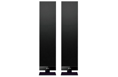

https://www.richersounds.com/kef-t301-black.html

What's the low end of the KEF speakers like? You might need a sub too.

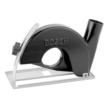

You can get shrouds for grinders for dust extraction. That and covering everything or even tenting off the area is what you could do if you chase the walls.

I did mine. Skirting off & used a hand grinder (with Henry attachment!).The neat chase was very easy to make good. I did a great job and then the missus had some bespoke shelving built which made the whole process redundant. ha.

If you are chasing, just buy a proper chaser, two angle grinder blades which you can space apart as required and adjust the depth etc. Makes for a much neater and consistent channel. Still makes a horrible mess if you have old plaster eg Victorian, which goes everywhere.....

For them money you're looking to spend on the KEF's you could get a pair of Q Acoustics floorstanders.
I've got the cheaper version of these and they are seriously impressive for the money:
https://www.richersounds.com/tv-home-cinema/floorstanding-speakers/q-acoustics-q3050i-black.html
They've got a really good bass to them but, as I have room, I'll be adding a sub soon.

Those chasing tools look fab, I didn't even know such a thing existed! Although I would normally jump at the chance to buy a new powertool it looks like it would make a reet mess.

Those chasing tools look fab, I didn’t even know such a thing existed! Although I would normally jump at the chance to buy a new powertool it looks like it would make a reet mess.
Yep, I just bought a cheap one from Screwfix as it only had to manage a few metres of cutting, very nifty bit of kit; but it makes a god awful mess and you'll be vacuuming for ages afterwards.
