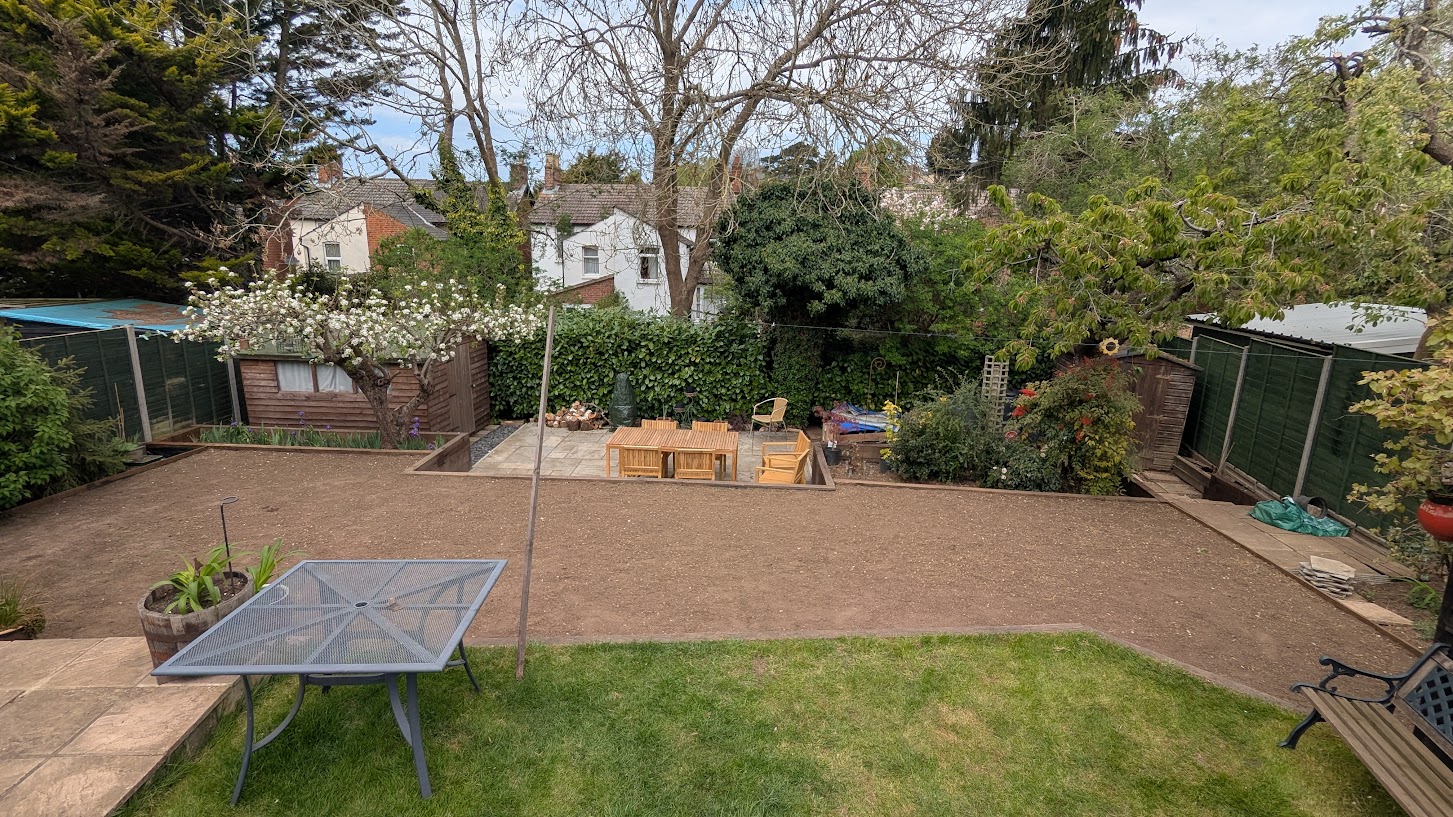

I've recently levelled a smaller sloping garden (approx 60m2), mostly by hand.
  • Dug over turf by hand
  • Used an electric tiller/rotavator to churn it all up
  • Raked it all level (using a combination of rotavator, rake, scaffold board)
  • Compacted it down (gardeners shuffle)
  • Added some pre-turf fertiliser
  • Laid turf
Before doing the above I've also spent a lot of time adding retaining walls and edging to give clear boundaries.
But just for the levelling, the cost was about 280 for the turf, about a tenner for the fertiliser and I bought the tiller from ebay for about 35 quid.
Obvs there's no hourly rate in that, but I'd estimate that added together it took me (an amateur) about 3 days.
Whether 1k is worth it, I guess is up to how much you value your time versus having someone do it for you.  If you're talking 3 times the area I worked on, then having someone else doing the grunt work def sounds appealing 😀
Posted : 03/06/2025 9:17 am

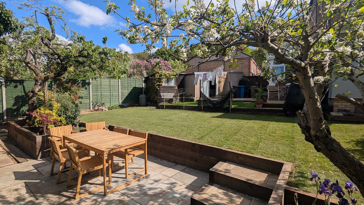

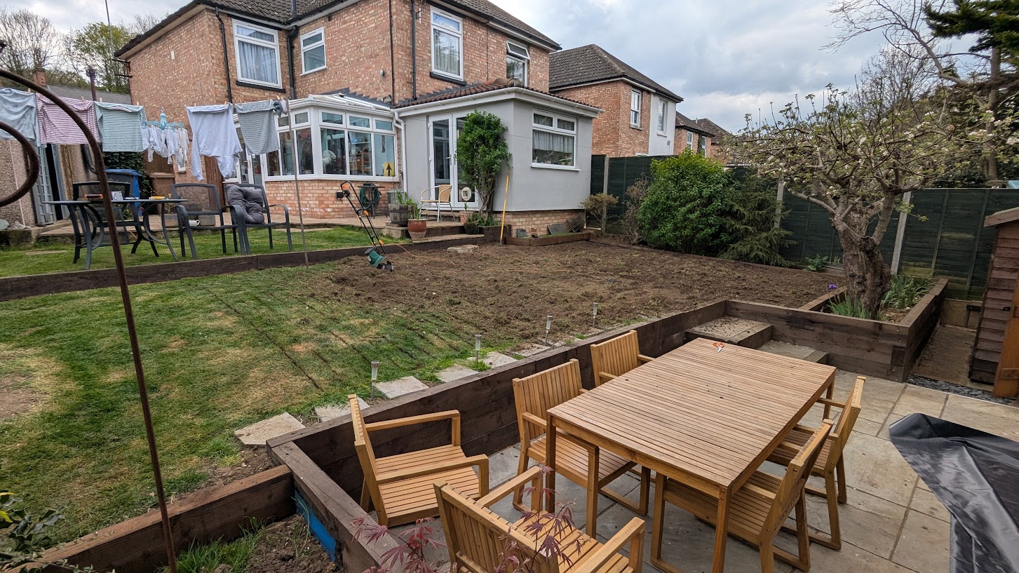

Posts: 3518
Work in progress
Waiting for turf
Tadaaa
Posted : 03/06/2025 9:22 am

The house is a semi where the “uphill” side is attached and the gardens are only a few inches different after levelling.
There’s a retaining wall (and my new amazing gabions) on the far side, with a 4’ drop into the next semi’s garden.
Posted : 04/06/2025 12:37 pm
