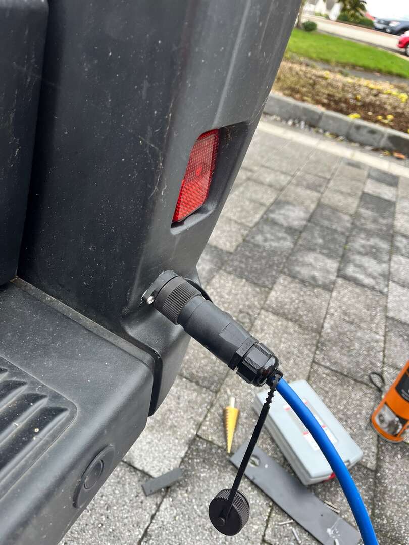

I just fitted one of those to my van after the original blue one under the rear bumper gave up.
There’s a chance it doesn’t “meet the regulation“ for camper van power but I decided that I am OK with that as it’s rated to 16A. It’s a nice neat solution although was a bit fiddly to fit through my bumper and needed a PVC waterproof boot on the back - you might not need this if you get one of the other mounting options.
The connector is on the end of a 1m long cable with a normal blue connector on the other end so I’ve got options which cable I can connect to.
