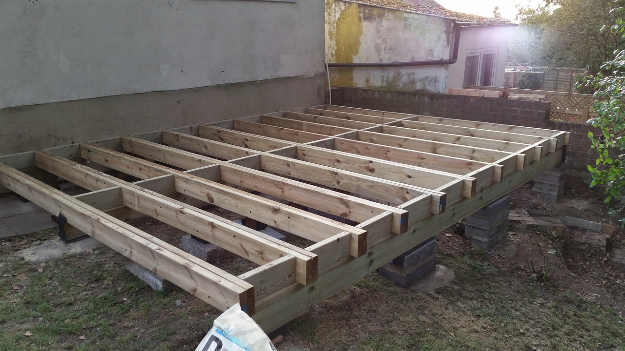

Cabin base - mounted on concrete block pillars on concrete foundations about 1 fott deep. Extra strong timber because of the weight of the hot tub full of water.

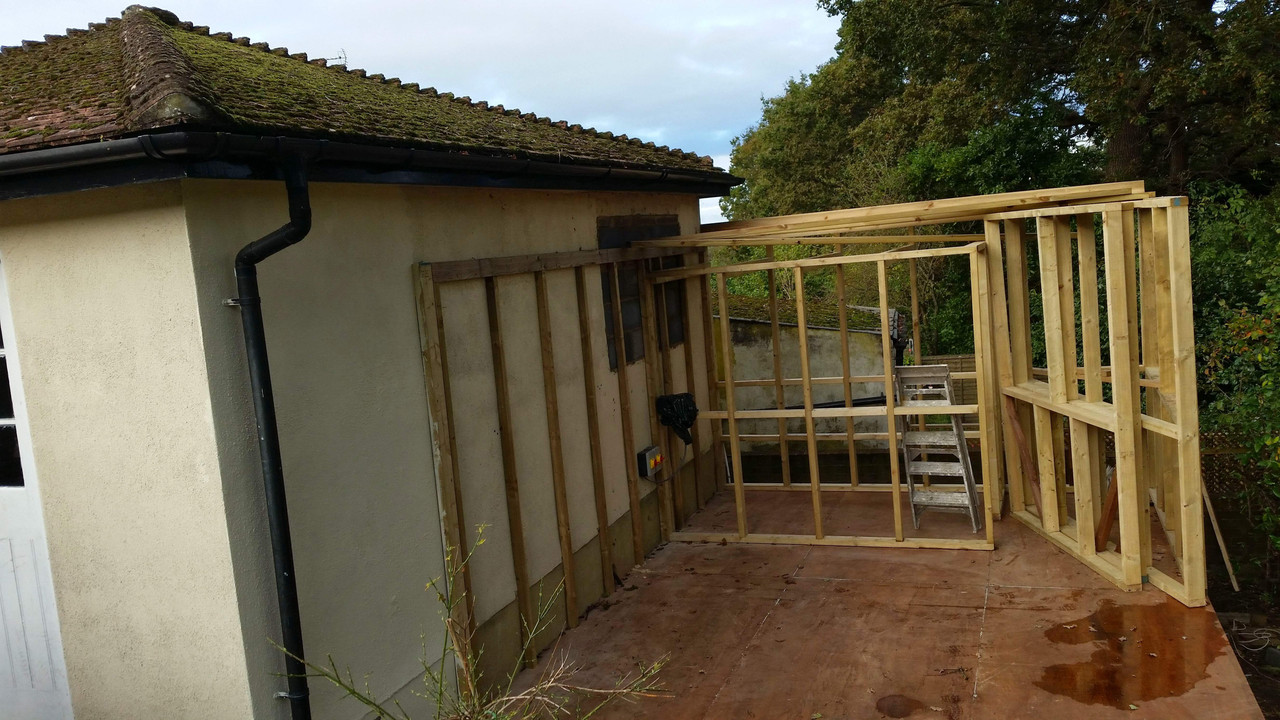

Cabin walls made as sections from standard length timber to minimise cutting. The long side is 2 x 2.4m and the short side is 2 x 1.8m. Each wall has one half fixed and the other half will be top mounted sliding doors to allow feeling of openness when in the tub rather tjhan being shut in a box, also big windows.

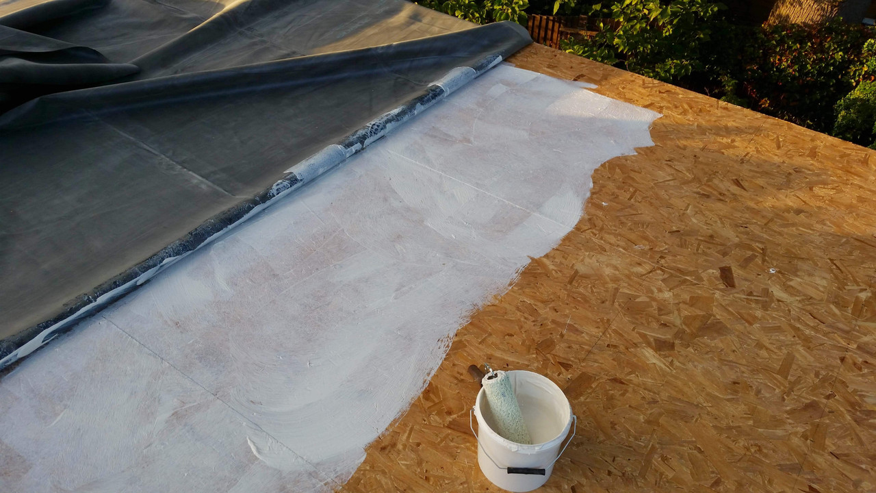

Cabin Roof. EPDM rubber is slightly more expensive but comes in wide strips and is really easy to fit. Also almost impossible to rip or pierce.

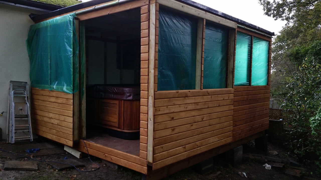

Cabin Cladding. Some kind of overlapping planks, I am sure someone else will say what, with each one nailed in place with the nails hidden by the next plank. A pain to do but very effective and only recoated once in 7 years so far.

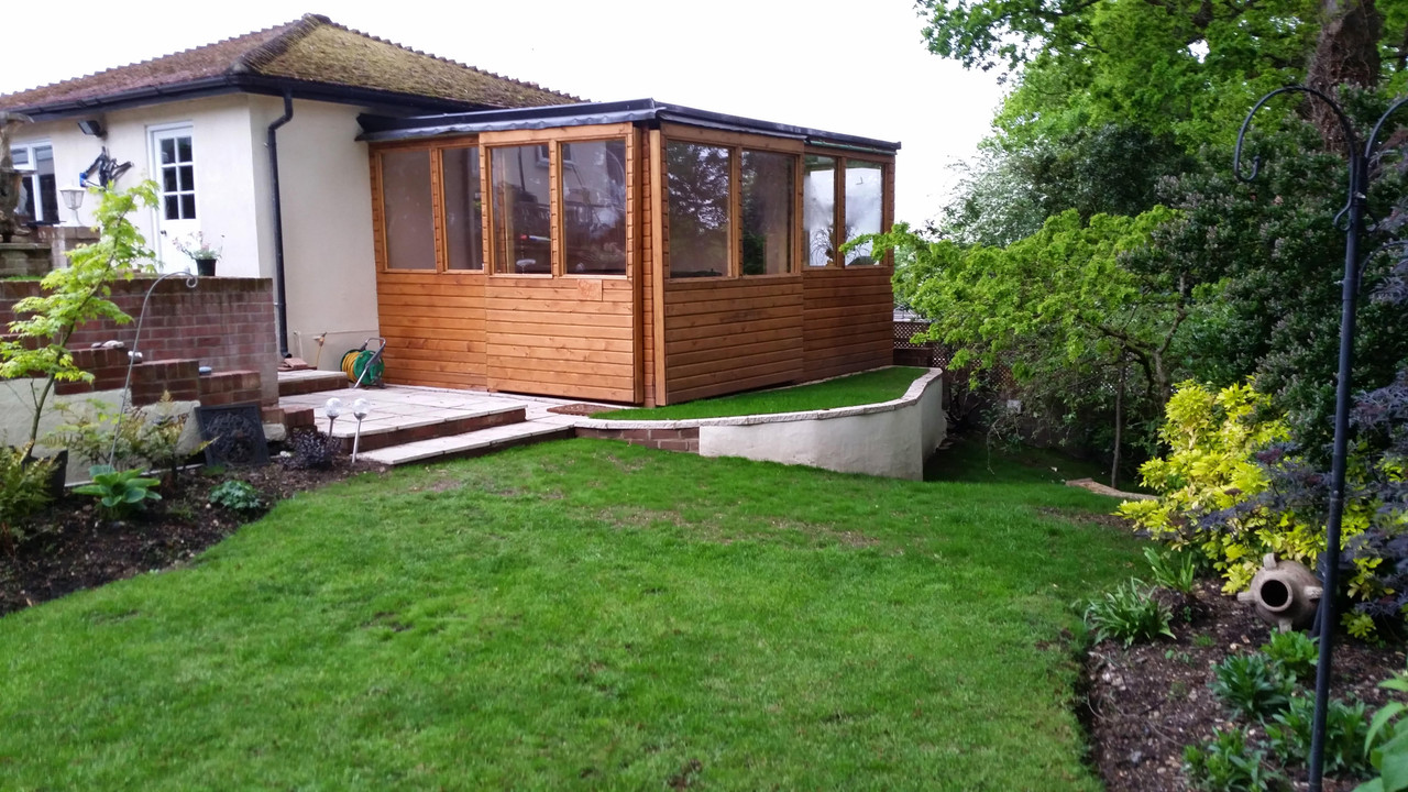

And the end result.
All built with just a sliding chop saw, drill, hammer and a router I bought to do the quartic around the windows. I was amazed how simple it was once I thought it through and planned it first.
