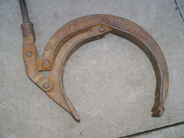

Sidewalls are fragile things. Just in case Molgrips hasn't already Google-imaged "car tyre bead breaker" for a hundred and one good ideas and tools I'd like to suggest dropping a car on the bead is a bad idea.
Edit to add: I've got one of these and I'm just about strong enough to break a bead with it:
[img] http://www.mig-welding.co.uk/forum/attachment.php?attachmentid=10307&stc=1&d=1248379770 [/img]
2nd edit: and thinking about it it would be useless with the width of tyre on my current car.

I've only ever swapped one car tyre (but literally dozens of motorcycle tyres, my record being nine minutes if I recall correctly and I know many who can do it much quicker) and it was dead easy with the right levers, but it was not a very low profile tyre. Google will bring up lots of ways to break the bead with two bits of wood and a hinge - this will do any width of tyre. The use of tyre lubricant helps too.
How dear is balancing at the local tyre fitters?

You need some safe way of breaking the bead. Our one is similar to [url= http://www.ffx.co.uk/tools/product/Tc968%20Tyre%20Bead%20Breaker%20Tc968%205051747391000%20Tc968%20list ]this[/url]. After that its a case of tyre leavers, rubber mallet and soapy water. Its quite physical and there is a knack. If you're ever near Bournemouth try and contact me and I'll show you.

a.Tyre changer similar to Sealey TC960 , can get them with air powered bead breaker - much faster.
b.A compressor
c.tyre soap
d.practice
you can balance yourself or mark the rim, and note what weights were where and put them back in the same place.( new weights buy them from tyre place)
That will cost you £200 or so and help with your tubeless bike tyres

What about this for a bead breaker?
I'd say no. I've broke a tyre bead with a bolster and and a lump hammer before (more or less what you're proposing there) due to emergency in the middle of France and it is tough. You need some sort bead breaker with a long lever. Even with that you still regularly have to move round the tyre a bit at a time.
Posted : 14/11/2012 11:00 pm
