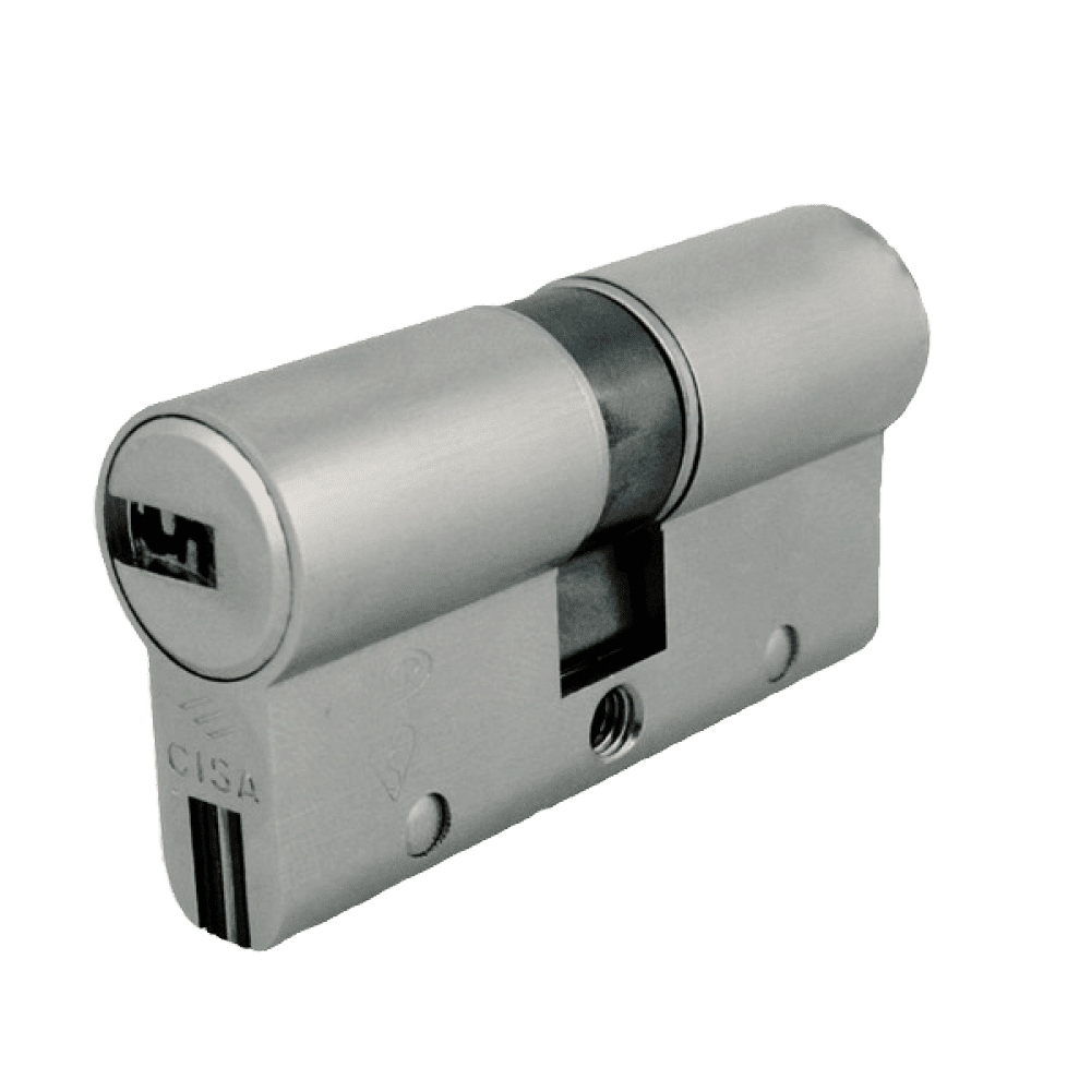

I'm after a few new cylinders, ideally ones you can unlock / lock from the outside if there's still a key in the lock on the inside.
I've only found one lock with this function, abus E60
Internal thumbturn isn't an option has to be key both sides.
Are there any others around, the abus would probably do but ideally prefer something anti snap, don't think the abus has this.
Are there disadvantages to having the key inside / outside feature, I assume there must be as there don't seem to be many locks with it.
Thanks

CISA do them, we have them fitted. Anti bump and anti snap too
Here https://www.barnsleylock.co.uk/cisa-astral-s-anti-snap-double-cylinder-4052-p.asp

Sharkey's cisa lock looks like the winner at the moment.
Can't use a thumbturn as not allowed for insurance purposes, and as onzadog says, key can be removed from a normal lock whereas thumbturn can't.
The cisa ones are available keyed alike as well so one key and will work if key inside or not.

I have the Cisa Astral locks mentioned above. They work with the key in the other side of the lock. I think the smallest I have is a 35/35 and I am sure that works with a key in either side of the lock. Also bought from Barnsley who have been great in supplying additional locks and keys.
