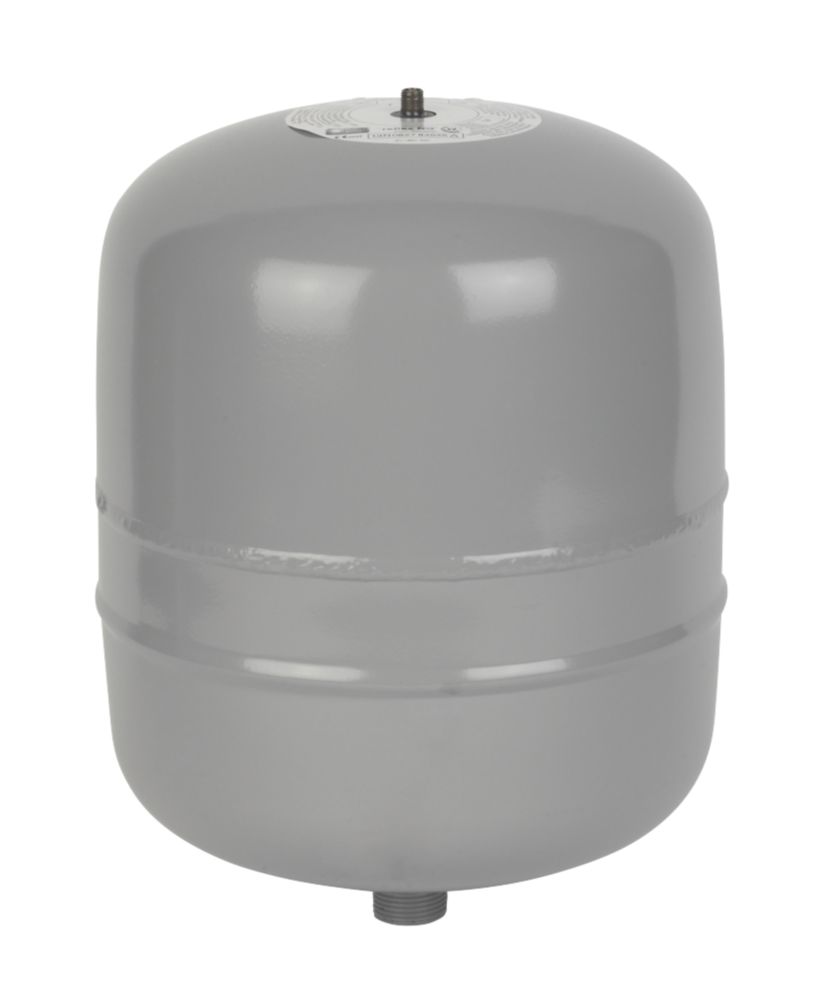

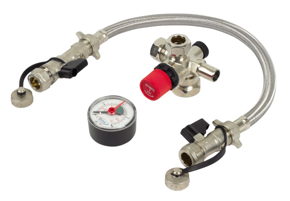

seems pretty symptomatic of an expansion vessel failure.
Unfortunately you're not allowed to fit one in the CH circuit yourself...but that's what Id do (and Im not qualified to either 😈 ), with a new tun dish and outlet 😉
[img] http://s7g3.scene7.com/is/image/ae235?$p$&layer=0&size=281,281&layer=1&size=281,281&src=ae235/71018_P [/img]
[img] http://s7g3.scene7.com/is/image/ae235?$p$&layer=0&size=281,281&layer=1&size=281,281&src=ae235/92562_P [/img]
about £100.

OK, So we have established your pressure vessel has lost its air cushion..hence the safety valve running. Could just be a case of pumping it up to correct pressure, job done.
It could be the diaphragm has perforated or failed in some way. Easiest way around that is fit another vessel somewhere else in the system, Not too difficult but locate near a drain or outside wall to run expansion into.
On the other hand you could have a leak AND a faulty vessel but that’s highly unlikely.
Buy a 8 ltr expansion vessel. Temporarily fit it anywhere you can. If it solves the problem either re-pressurise the one on the boiler or fit the other one permanently.
Lastly, a vessel cant be too big but it can be too small (Capacity) so.. if you buy one and re-press the original leave them both in line.
Posted : 21/12/2011 5:57 pm

£275 isnt too bad. In my post above the parts (excl copper) is about £100 and would take half a day to do so that's kind of BG rates I guess.
If there's room in the cupboard, Id go for the 8 litre expansion vessel unless your boiler is still under warranty.
Posted : 21/12/2011 6:03 pm

However I suggest either fit or get someone to fit a new vessel (£50 + Fitting Tops).

When I did it the whole job took about 2 hours, including draining etc., and about £60 in parts. The new filling loop in Stoner's pick shouldn't be necessary unless you have some weird setup on your boiler.
