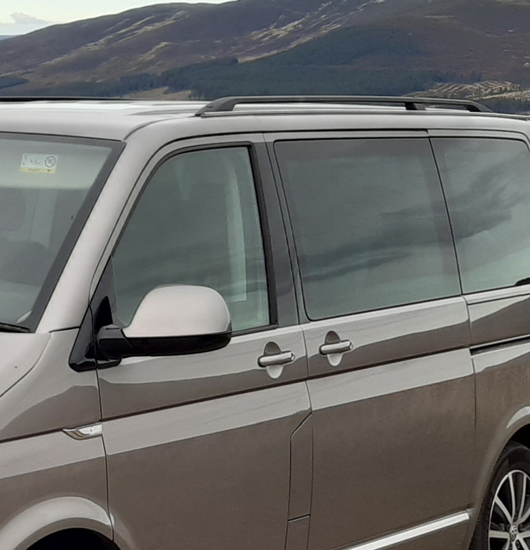

I'm looking for some advice on transporting 2 Canadian canoes on top of a T6.
The van has the side rails in place already:
Any thought's / tips on the roof bars / canoe mounts / lashing etc that are required to make this possible?
(I don't have the canoes yet. Mounting them on a vehicle is the first step in this project / adventure.)
