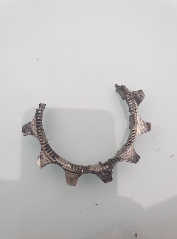

Posts: 902
broken thing
I'm 13 1/2 stone, no Sir Chris Hoy in the leg department. I know s*** happens, but I've never had another cassette cog do that.

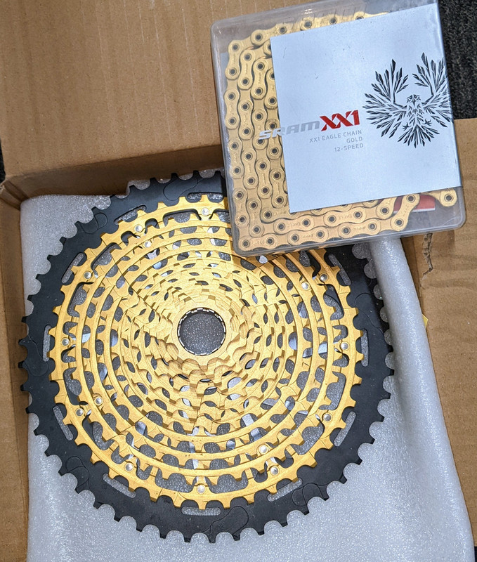

Posts: 16684
I'll be selling this gold bad boy when I can get around to it, along with the chain. Both brand new, XD, 12spd.😉
The cassette is a 9t- 50t so massive range.
