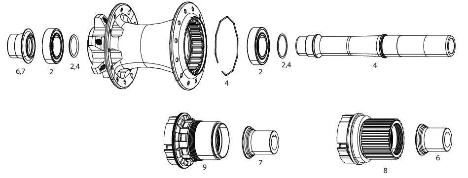

p/n I need is 11.2028.062.005 - END CAP SET REAR ZM900 HUB 12X148 MS
#7 (I have the freehub, just need the end caps)ZM900

A question before i dig a little further into the parts box..
You said the wheels came with XD, and #7 on the diagram is the end cap for a XD driver?
Do you mean #6? And if so, is it still the same part number?

Yes, got my 6 and 7 mixed up  I have everything required to use XD - so End cap 'kit' number 7.

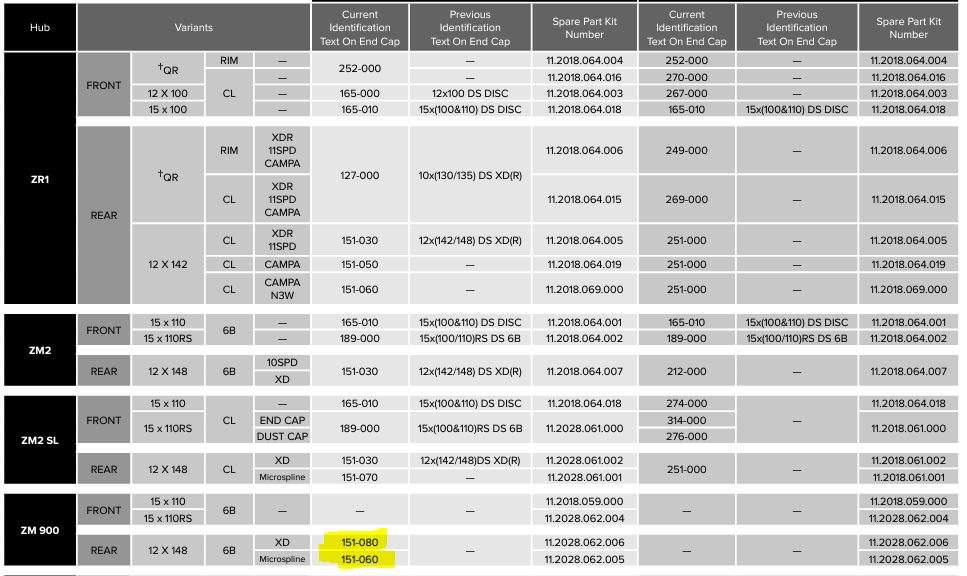

That doesnt match what I'm seeing unfortunately! Note that end cap 'kit' 6, includes the same non-driveside piece. The drive side piece, however, is different - as reflected in their 'end cap identification' chart here
and highlighted in yellow here:
(Drive Side on the left, NDS on the right in the table).
End caps
The outer diameter of the flange on the one I need (#151-060) must  be smaller, as the 'XD' version does not fit inside the threaded portion of the MicroSpline driver. The length may also be different, depending on where the outer bearing sits on a MS driver.
Help much appreciated - if it comes to it, I might get the existing Drive side end cap #151-080 turned down and see if it works. Not ideal though.

However, using the 151-060 code
Could you not buy this -  https://r2-bike.com/Zipp-End-Cap-Set-for-ZR1-Disc-Brake-rear-Hubs-12x142-mm-Thru-Axle-Campagnolo-N3W
I'm very aware its the wrong freehub and wheel spec. But the code is the same, and therefore they must use the same end caps
