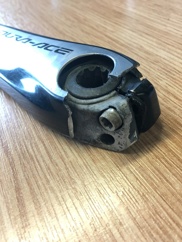

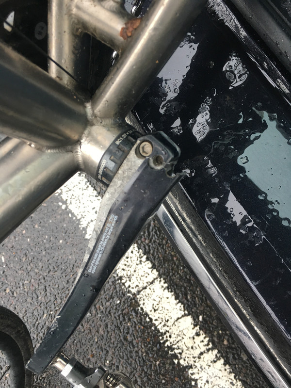

I'm a twerp. Last week I wore different shoes cos of the rain and left side felt odd. Put it down to the cleat. Then thought, could be the pedal.. pedal looked ok, kept forgetting to investigate further. On the way to work today.. hmm feels .. worse... clonk, there it goes. Have to ride home one-footed, sling it in the car. MTB cranks last forever - Dura Ace - 4 years old that is. Bought off the classifieds (was new), so can't warranty even if they would.
Can I use a XTR crank arm temporarily until the replacement turns up?

I can't even work out what's happened, has it 'peeled' open around that hole?
Posted : 01/10/2019 10:57 am
dunno really - I'll check when it stops raining. But looks like the outer coating(?) has corroded and sheered through. Must've snapped somewhere on the arm though as it's gone so badly out of alignment.
I got home but where its so bent it contacted the chain stay, s'why I had to go one footed doing like half-rotations. Luckily had only got a few miles from home.

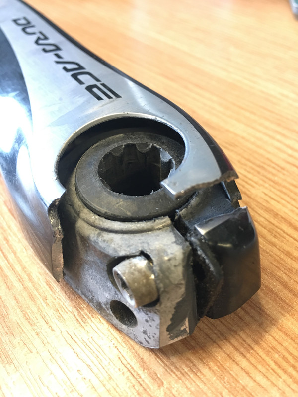

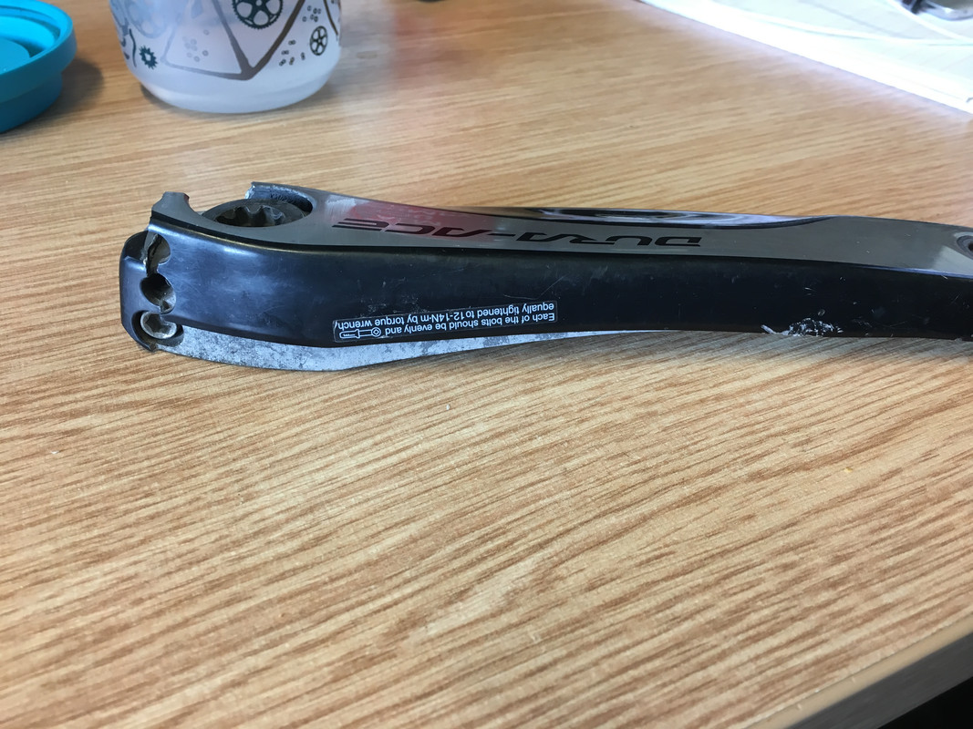

Better pics
So the outer shell snapped - I guess the inner, dull looking alu part doesn't go right to the pedal insert, so hence the distortion.

Posted a pic on Shimano's FB page - their response: RTFM. I'm never buying Shimano again! (Well, maybe some)
Posted : 02/10/2019 4:58 pm
I can't see how they can claim that's user error, particularly?
Posted : 02/10/2019 5:02 pm
had a similar failure with ultegra cranks. more common than you think
Posted : 02/10/2019 5:04 pm
I can’t see how they can claim that’s user error
Nah, bollocks that is. Didn't expect anything, as they're out of warranty, but "use a torque wrench" is bullshit. I do- and they been on the bike 2 years with the current BB, I think too tight bolts would've revealed themselves before now! But waddoIknow
