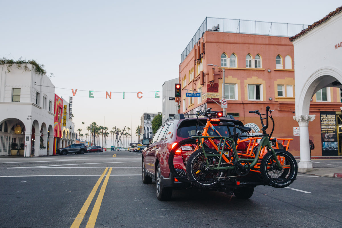

Had a Thule one for a few years and its great. Very solid and does not move. Used it on a regular basis in the UK and for our trips to the Alps. Usually has four bikes on it
[img] http://images.fotopic.net/?iid=ytz2sb&outx=600&quality=70 [/img]
