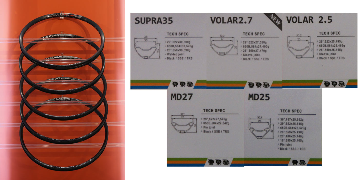

I've googled Alex Volar 2.5 27.5 to death and can not find the weight of the rims.
Does anyone know the weight please?
Posted : 08/01/2017 10:09 pm
Posts: 6410
465g alledgedly- which is actually not bad for a 30mm wide rim.
[url= ]Link for pic[/url]
Posted : 08/01/2017 10:16 pm

Posts: 7018
I googled 'Alex rims' and the first answer was the Alex website with all the specs. 😉

Thing is the arch mk3 is only 40g per rim lighter, I'm sure it's a better rim, but don't make the swap for weight. Not sure what spokes the current rim is built on maybe some weight saving there. Op what is the weight of your complete wheeelset ?
