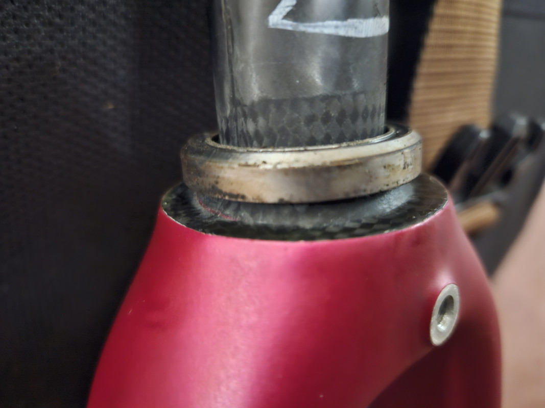

 Aidy
Posts: 2977
fork with bearing
Yeah. Tried that. Sits higher up than I think it ought to.
Posted : 10/01/2024 9:14 pm

Posts: 30978
Try one with a bigger ID? What’s that one?
