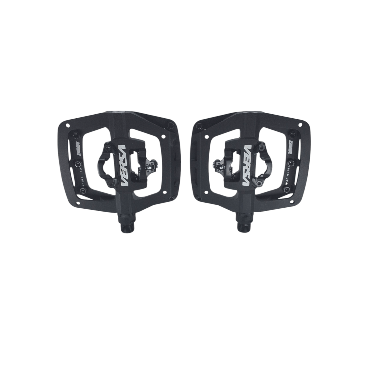

Posts: 1782
For very similar reasons I went through the same thought process and ended up with DMR Versa
https://singletrackworld.com/2020/03/dmr-versa-pedal-clips-flats-or-both/
https://www.bikeparts.co.uk/products/dmr-versa-pedalblack
