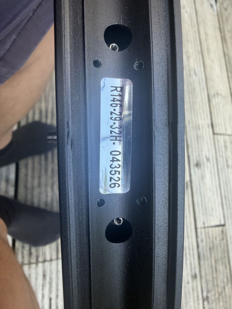

Also the holes are quite recessed in the rim as you can see in this pic, so the case tape probably hasn’t been pierced by spoke home. One thing I did notice and forget about was where the rim was welded, there’s remnants of penetration on the inside where the hooked part of the rim is. If it was leaking because of that, I guess it would leave there and not find somewhere else?
Anyone know what these holes are for?

Posts: 112
Posted : 04/08/2026 1:51 pm
Posts: 112
Also thinking about bit, I used the sharp end is a pair of scissors and that’s probably elongated the whole and as previously pointed out, has travelled along the rim to find a weak spot to leak from.

I think those holes are something to do with the welding, I think the rim is pinned first with a lump of metal on the inside, and then welded? Might be making that up, I remember on my old Mavics something would come loose under those wee holes and slide back and forth (only noticeable in stand) and I think it was the lump of metal used to pin the rim together.
Edit: DT tape was very sensitive to how you made the valve hole, I think if you accidentally put too much tension on the tape, it would split very easily when you punched the hole for the valve, ask me how I know 😖

13thfloor is right about the holes, they're basically part of the assembly process, some manufacturers weld them up too but it shouldn't matter, the tape makes it airtight anyway.

Is that a little crack right on the outside edge of the rim through the hook? To the left of the product code sticker.
