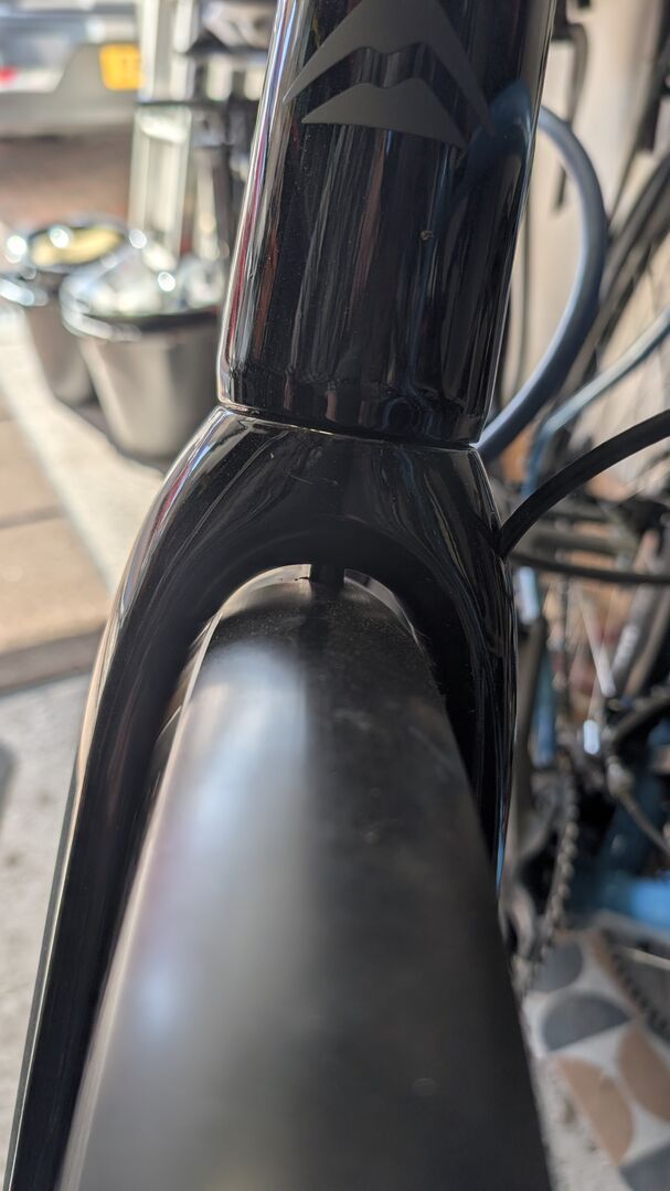

Fork only has vertical mounting hole - see below. Any suggestions of a light mount that will work here? I could extend the cable (it's an eBike with integrated lights), but would rather drop it from bars to just next to mudguard, so it shows under bar bag.

How heavy is the light unit. Could you rivet a mount to the mudguard just in front of the steerer?

How does the mudguard fit to the fork? Screwed in at the back?

L shaped bracket sharing the mudguard bolt?
Good call especially if that's an aluminium mudguard.
Would probably be useful to see the current light and mount to make other sensible suggestions.

You can get handlebar mounted brackets that drop down and hopefully below your bag. Toppeak bar extender, Wizard do a fork bracket that off sets the light to miss a bag I think? , not sure if that fits your fork hard to see in the photo.  Klite do a drop down mount as well which has a Go Pro type mount ( then get a suitable adaptor).   SJS cycles usually have a variety which may suit as well, esp for mounting on fork.
https://www.sjscycles.co.uk/lighting-spares/klite-alloy-handlebar-mounting-system/
https://www.topeak.com/global/en/product/209-BARXTENDER
See the pics of the Top Peak. Quite adjustable.
Vertically from below.
Carbon. No bung - it's a proper threaded hole.
It's a Lezyne E-Bike Power STVZO E115. So not too heavy.
Screwing onto the mudguard might work.

I could awear blind there is a bracket to fix to that mount but can't find it.
Very easy to make one though.

Something like this?
You may need to double it up if light heavy?
Portland Designs have a few different brackets etc.  And long and short versions as.well.
https://www.condorcycles.com/products/pdw-front-hanger?variant=44762167771457
