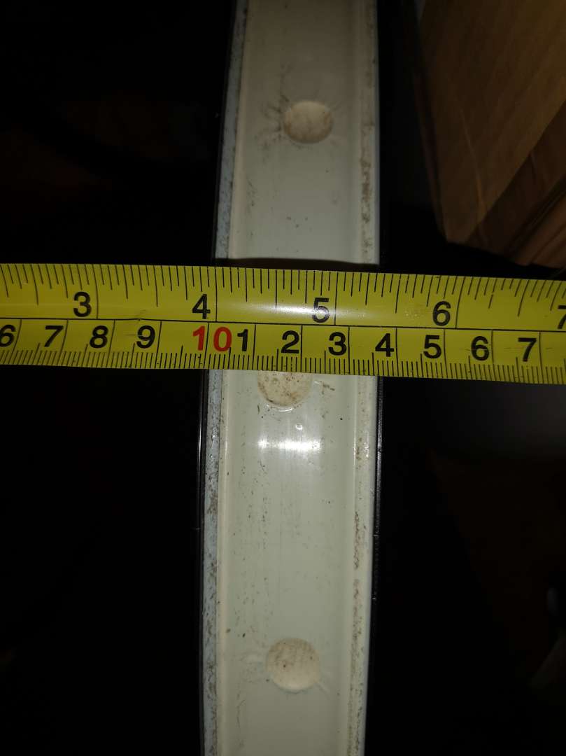

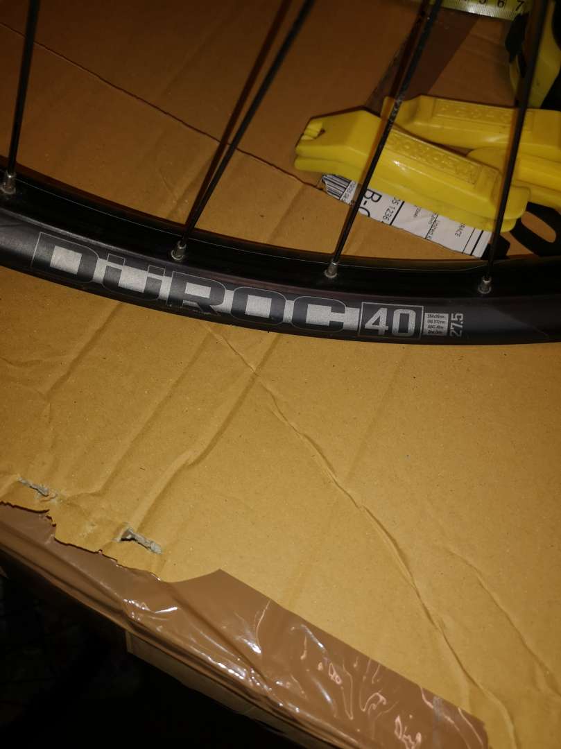

 IMG_20251017_172831.jpg IMG_20251017_173127.jpg I'm looking for some 39/40 mm tape for my mate's bike.
I've seen wtb for a better price than Stans, not seen any Tesa in that size.
It's for this wheel so assuming that's the size I need. Any help appreciated ta.

40mm Tesa tape from where, I've not seen any?

Amazon does a 50mm. I'd be tempted to seat it with a tyre and tube. After a day, just run a scalpel under the bead of the rim to trim it down

There's 40mm Tesa4289 on AliExpress, whether it's genuine or not I don't know. Have bought unbranded rim tape from a couple of sellers there though and it seems fine.

That is a good idea, didn't think about trimming it down.

Yes I had a look on there yesterday and ordered some 40mm Tesla, well I hope it is!
Will clean up wheel fit tape and fit tube in new tyre overnight then try the Stans.
