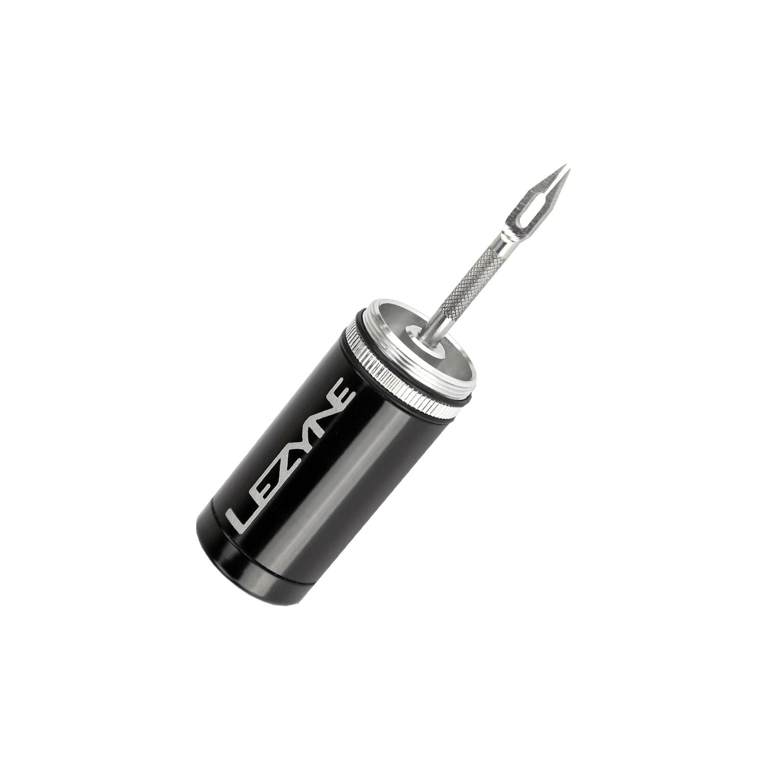

Just been looking at this but was slightly put off by the expensive, proprietary repair plugs, compared to others (e.g. Decathlon one above, or Lezyne) which just use generic "plugs" instead. Am I overthinking this?
I liked the look of this one, as it happens:
https://ride.lezyne.com/products/1-pk-tbls-v104
